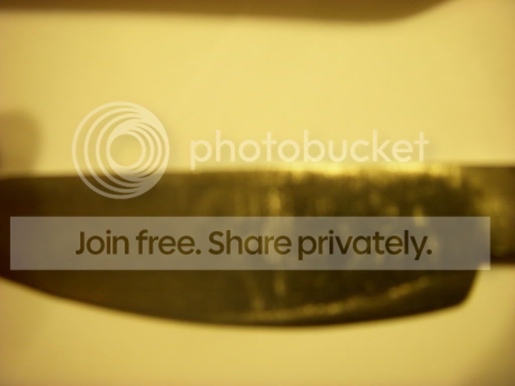

after removing the remaining scale after the heat treat i uncover a bunch of round marks on the blade. they take quite a bit of work to remove and was wondering if this is normal... thanks
i put the knife in the forge (air induction coal) and removed it when it was orange and quenched it in motor oil.
I believe you overheated the steel. A coal fire has the ability to ruin steel in a hurry. Maybe you could give some details of the forging process also?
I was going to say that it could be one of three or four things, none of them good and all related to either getting the steel too hot or keeping hot for too long.:eek: "little circles" sound like grain growth or maybe decarb.
Can you grind through them? Has one broken or can you break it to see what the grain looks like? Try etching it and see what it looks like....
i can grind them away but it takes forever, im going to etch it and post pics in a few minutes
thanks guys
im gonna post pics when its doen etching, but for now il tell about forging process, i dont really know any fancy terms, but i got it dull orange, the chart i have describes it as approximately 2350 the chart is from Wayne Goddard's book the wonder of knife making (after i made my rail spike knife my gf got it for me as a gift so i wasent completely in the dark) and beat it to shape after the first heat treat i quenched it in water and the point curled up cause i had it really thin so i cut it off and shortened the blade (about 1/2 inch) i hand rubbed it up to 400 and tried to heat treat it and now here we are.... i hope that is enough of an in-depth enough description of forging process...
i didnt even think to check the chart to see if it was in the temp range suggested by the heat treating data book. it says 5160's range is from 1600-1700 the chart in goddards book says 1600 is dark orange, mabey i doomed my self... i just thought to get it hot and quench it... now i know for next time. im still curious what those rings are...
The rings are blisters from quenching when the steel was way too hot. You should use a magnet to test the steel. As soon as the steel is nonmagnetic quench it, if you wait too long it will have grain growth and blisters which result in an inferior performance blade. Did you normalize the blade first?

the quality of the pic is poor i know, but i couldent get it to see what i see. all those marks are "blisters" is this blade still useable? or should i just stop working on it and start another project? did the heat treat at least make it hard enough to use or did it just destroy the grain?
I say toss it and make another one. Are you going to use a coal forge again? If so you will need somebody to walk you through it.
From the pic I can barely see a blade-shaped thingy, not much help there.
