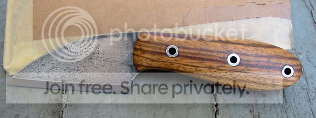

I'd like to make a small sheepsfoot blade for a first knife. The blade is 3 1/4 inches long, the handle slightly longer, I intend on doing a scandi grind on it. I'd like to keep all of the lines simple and smooth. Should I mirror the blade curve on the handle or keep it straight like this.
The blade will be between 0.125 and 0.2 inches thick at the spine, depending on what I can find. I like the idea of a shorter thicker knife that I can really abuse. Ideally, it will be out of 6065 or 01 steel. Scales will be Jatoba (Brazillian cherry)
Constructive feedback is always welcome, i'm here to learn. I've always liked sheepsfoot knives for general utility. I find myself slicing and shaving more than stabbing, so I don't really need a sharp point. They seem like one of the easier profiles to bust out for a beginner knife. The vertical line denotes the difference between blade and handle area.

I like the utilitarian super simple style, but your drawing scale is out of whack. If that knife was around 7 3/4" overall length, that sucker would be almost 2" tall.
What alb1k said, plus either grind a semi-circular "finger groove" behind the edge, or allow for a small guard. You're just asking for a cut finger, especially with such a short handle.
What they said. :D Do the old standby and cut one out of a cereal box and see how it feels in your hand. Wrap the handle in tape to build it up.
The top spine would be much more comfortable I believe with a radius from the tip to the heel. Curves are also naturally more pleasing to the eye. :thumbup:

I agree with what James said- build in a guard like this
3/32" 15n20 steel @59-60 HRC. 2 1/2" blade, 6 1/8" OAL
I would stay 1/8" or less on that small blade, especially if you want to Scandi
I also agree with Fluidsteel too, make up cardboard cutouts and play with them for a day to refine your design.

Keep the shape as is if you like it. Simple and utilitarian.
If you want to make it a lot nicer and easier to use,keep the sheepsfoot shape, but drop the blade a bit from the handle, add a bit of shape to the handle.....sort of like "The Count" showed . I would go .125" max. on the thickness.
The photo was scaled when you scanned it. That is why it is short and wide looking. Remember to unselect "Fit to frame" at the bottom of the scan/print pop-up.
Thanks for the feedback everyone. Changed the blade radius to begin at the handle, and added a choil for the fingers. The shape is more blocky than I would like around the choil and butt, but that is a function of cheap rendering on sketchup!
Any further suggestions would be very much appreciated. Also, I added my location.

Looks good to me. I would say give it a go. No sense in spending too much time "tweaking" such a simple design. I'd make a cardboard mock-up so you see how it feels in hand and you can adjust mostly the size after that. I almost never get the size right on paper. In any case, the template is only a guide as the shape is changed a few times during the build. Well for me anyway.
Looking forward to your progress pics.
We could continue tweaking this forever. It doesn't have any glaring flaws or deficiencies. I think it's time to BUILD IT!
