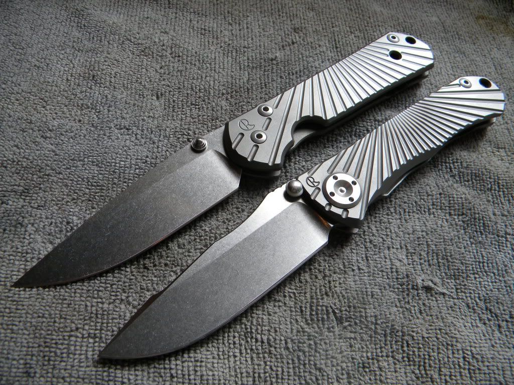

Here is a pic of one after I blasted it.
Looks good! Would you say it leaves a slightly smoother finish than the factory blast or about the same?
Do you mask off the micarta and screw holes or just blast it all?
Nice job man that looks great! Another good modification thread to refer back to. Thanks smi for starting and Antony for contributing!
I mask the micarta out probably do not have to, but I like the way it looks so I don't want to alter it. The screws are done with a Dremmel and scotch-brite wheel.
The finish is a little smoother than CRK's sandblast but that is to be expected, not really a concern with the micarta. The glass beads basically just peen the surface. I have reblasted just about every Seb that I have owned, and some for members here. I think it gives the knife a much more finished look. Dying to do a 25.

Here is something to compare to..Umnumzaan bead basted @ 60 psi with ceramic grade glass bead and a Lg Sebenza with a factory finish. (just before I bead blasted it)
Ok that is what I expected the glass bead blast to look like, more of a silver than a darker grey. There you can really see the difference.

Just finished beadblasting 3 of my Sebenzas and they came out great. All three had received a light scotchbrite treatment. Now they are a uniform silver color with a smooth finish. The texture is different from the factory finish, being more smooth than grippy. It took me longer to set up my equipment than it did to complete all three. I will try to post pictures when I have time.
