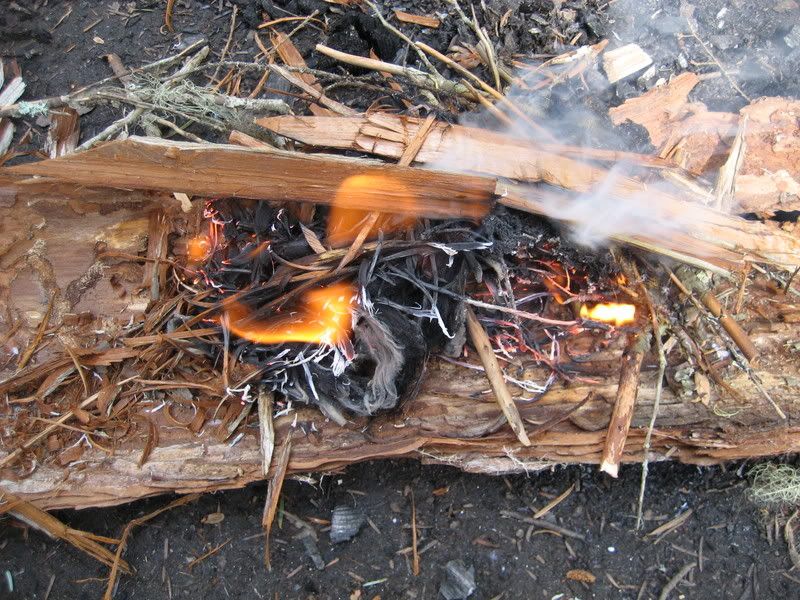

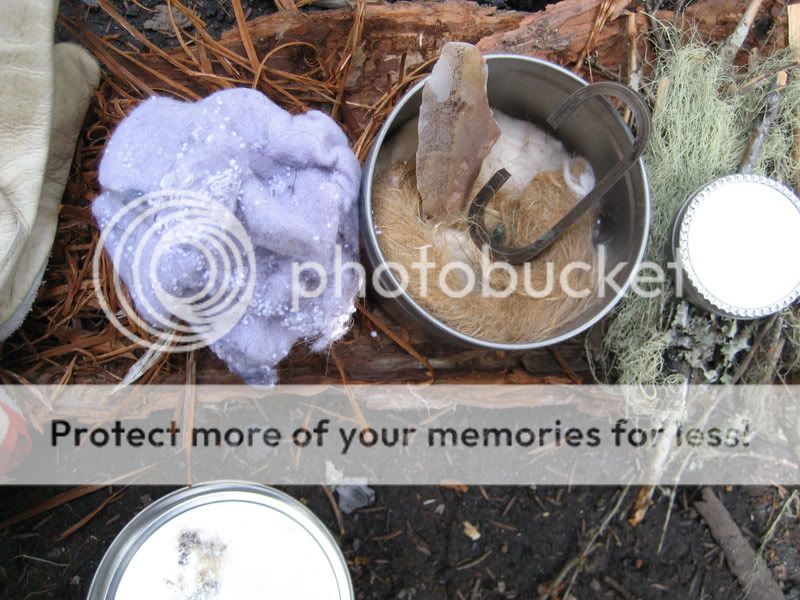

I used some flint, a steel, some dryer lint, jute twine, and char cloth just Saturday. Worked well.
