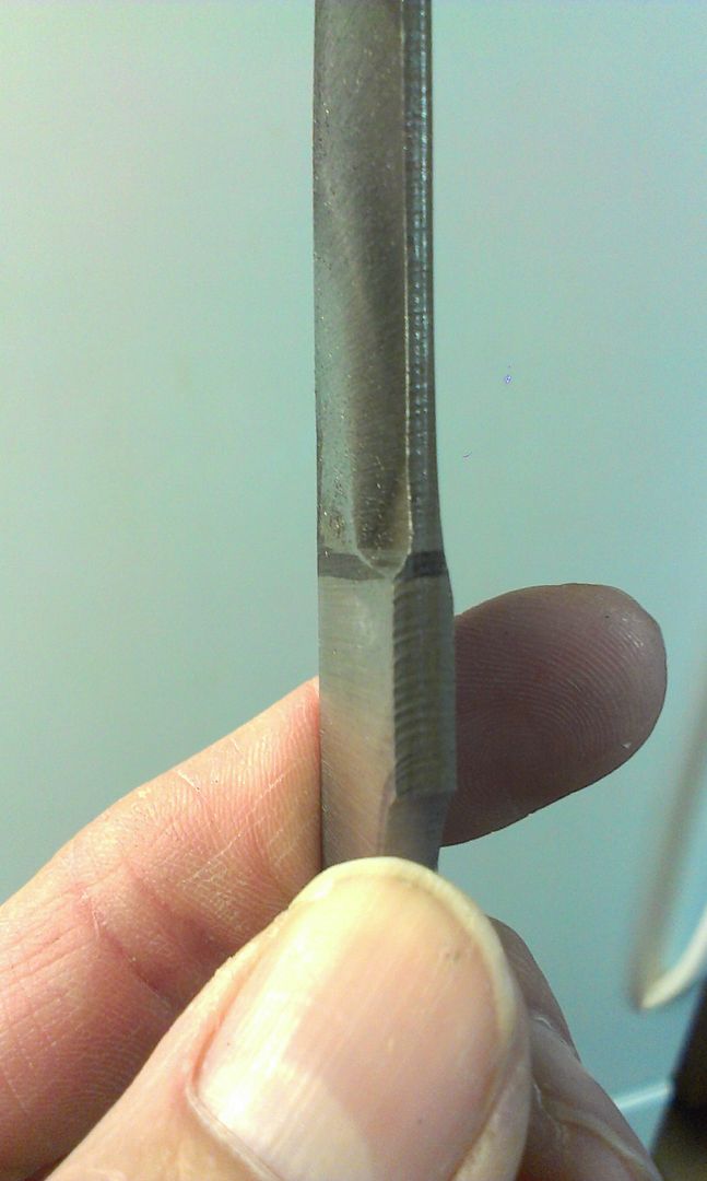

Hey guys. I need help with the proper way to make my plunges. I've read that using a chainsaw file is a good tactic but I don't know which type to buy, round or flat.
I'd have preferred to have the plunge start where the line is drawn but obviously I'm going to have to push it back into the bolster area. :(
Here's the side of the knife
Thanks for any advice.
DO you have a file guide? It makes a big difference. Even some mild steel clamped to the blade along the plunge line will help keep things in line. Use a round file for the plunge.

So a round file, then I assume I just follow the line up to the spine (if I decide on a full flat grind)?
Use a c clamp to hold your guide to the knife and the knife to the bench. Vice grips will work too until you start accumulating tools.
I use a round chainsaw file and run it along a piece of scrap steel that i hardened clamped to the blade. It helped me alot. I know USAKnifeMaker sells some file guides for the plunge that will line them up nicely. I was trying a bastard cut round file but found out real fast that doesnt work very well at all for me
Start the plunge 1/4th of an inch further up the blade then take it back to where you want it to be, this has helped me but is easier said then done.
If you don't have a file guide, just scribe your plunge line and superglue a small scrap of knife steel (say 1/4" wide by 1") at the plunge line. It will stay on for your work but can be easily popped off, especially if you leave a small bit overhanging at the spine.
I normally freehand most of my plunges and just carefully creep up on them, but on stuff where it is more critical, such as a plunge with no notch, I like to use the scrap/superglue method. I actually made myself a file guide, but find it bulky compared to the above method.

Some great ideas. I'm definitely going to try glueing a piece of 1095 to the ricosso. That seems to be the easiest thing to try first.

I often pin a sacrificial bolster on where the real bolster goes but extending up the ricasso to where the plunge will be .Then I grind right up to it.
use a round file and only file app half as high as you want the plunge to be.
The rest will follow when doing the bevels

I think it's worse in person than it looks in the pic.
The sides don't match up and it's just a dirty cut. The marker makes it look like it's ground straight up to the spine in the 2nd pic, but it's just the line drawn on the steel.
I wanted to ask for pointers before it got to a point where it would be hard to fix. From past experience I can see where this is going if I don't do something now to fix it. ;)

Try a half round file for the plunge and a Nicholson Magi-Cut for the rest. The half round will make for a nice plunge and the magi-cut will cut fast and clean.
I don't think you need a file guide, it is looking good so far. just mark it and file... practice will take care of the rest.

Its harder to get the plunges perfectly even on a knife without a guard. Put a sacrificial guard onto your pattern, use the guard to help you set the plunge, then grind it off. Its not rocket science either. Get them close and file them clean, then use sandpaper on small dowells to finish. A good set of expensive sweedish needle files will last you years and have the perfect round files for this. If its just a small bit, sometimes cratex on a dremmel will fix it right up. Eventually you'll get better and better with the belts and be able to do most or all of it with the edges of the belts on the last few passes. That takes time and practice so at the beginning you suffer the files and dowels.
