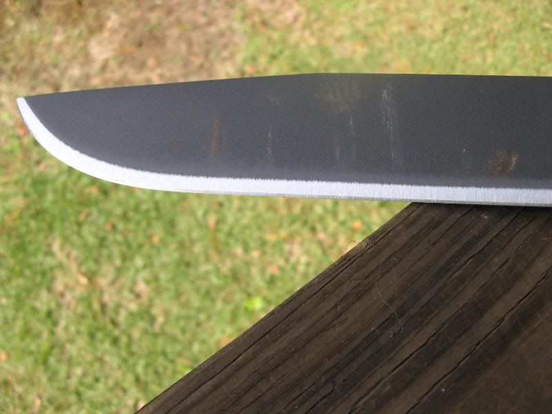

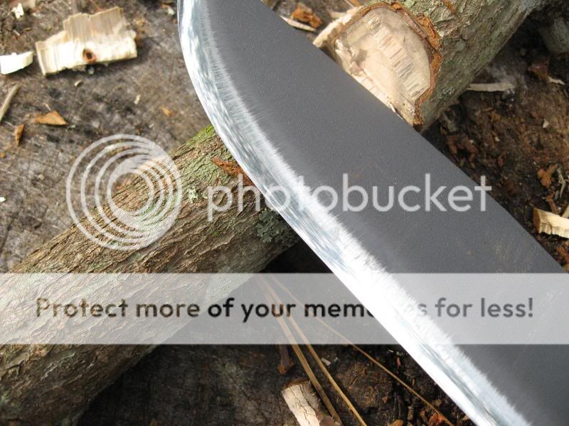

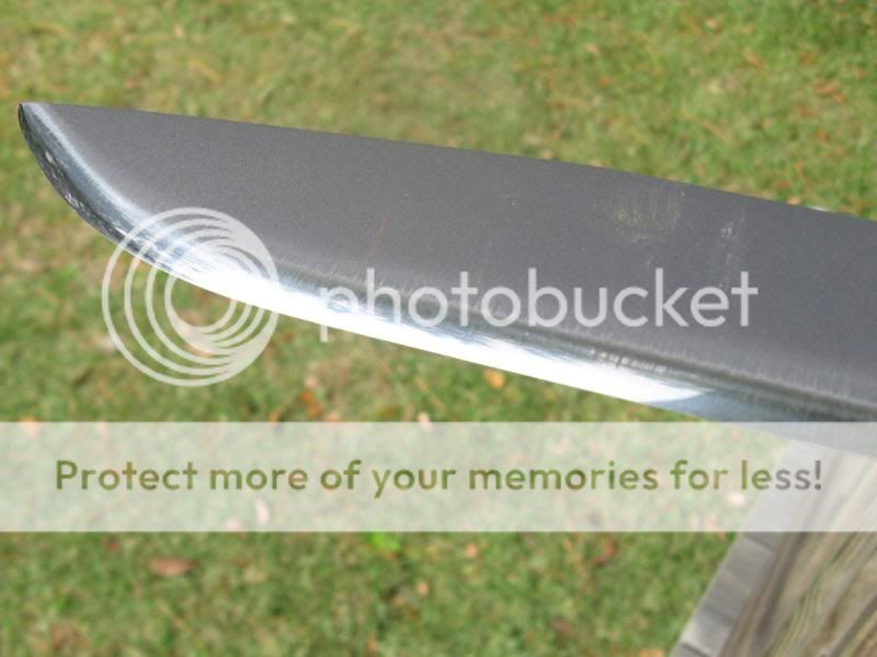

I noticed yesterday that my BW did not quite sail through the brush like my really sharp machetes and other bush blades do. It did not concern me, as those knives have very sharp convex edges. My BW came with a perfectly fine factory edge, suitable for chopping wood and even harder materials and very strong. But I plan to do a comparison between the BW and some other big blades on another forum, and to keep things fair, all the knives should have comparable edges. Rather than dull all the others, I convexed the BW. So I had some time this morning to start taking off some steel. Here you see the factory edge and how I am grinding down to it.
This took a while. Now time to go to finer grit belts. This should do it.

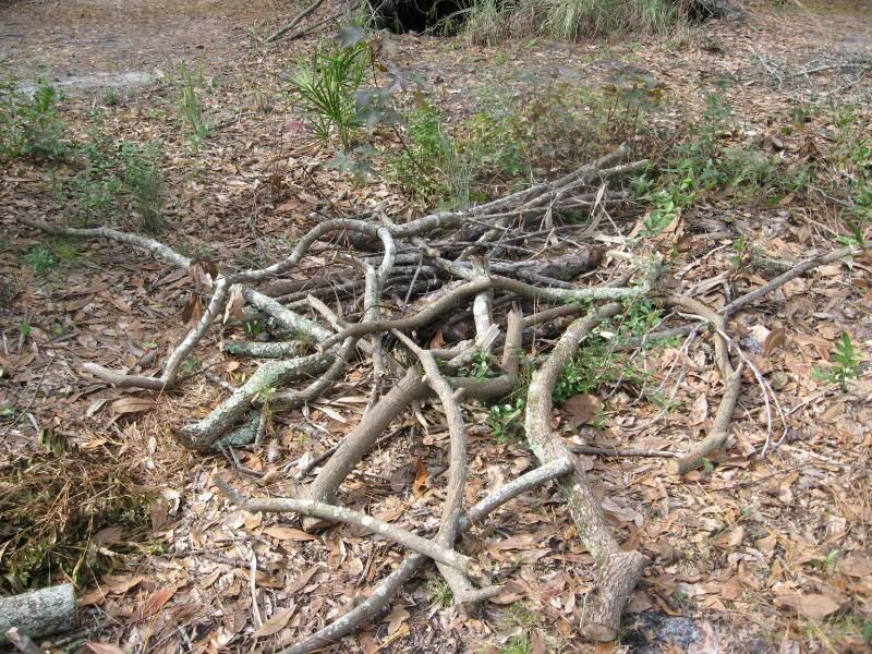

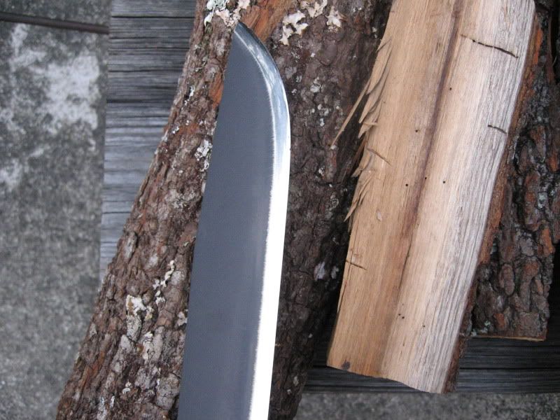

I have been saving this hard dead Bay wood for just such an occasion. Before I start slashing brush and palmettos, I need to test the edge on some hard wood. I did thin it out a bit.

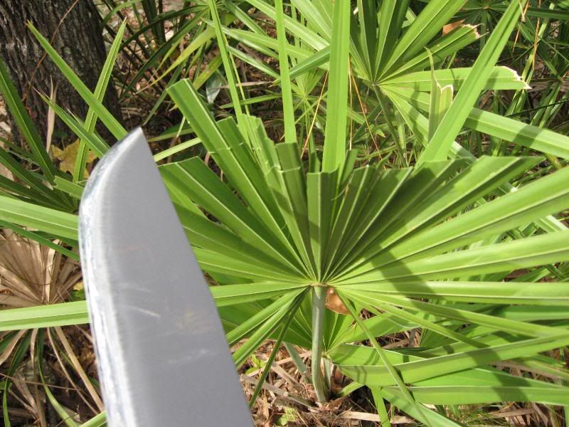

No problem. You can take INFI down pretty thin and it is still strong. Now to do a little bush wacking. One test I use on machetes and other bush blades is to slash through a free standing leaf. Any knife that can do that is good to go for my purposes.
Oh yes! Busse perfection. Bring on the competition.

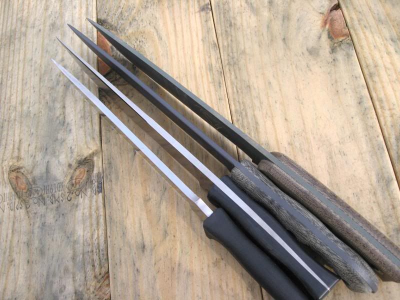

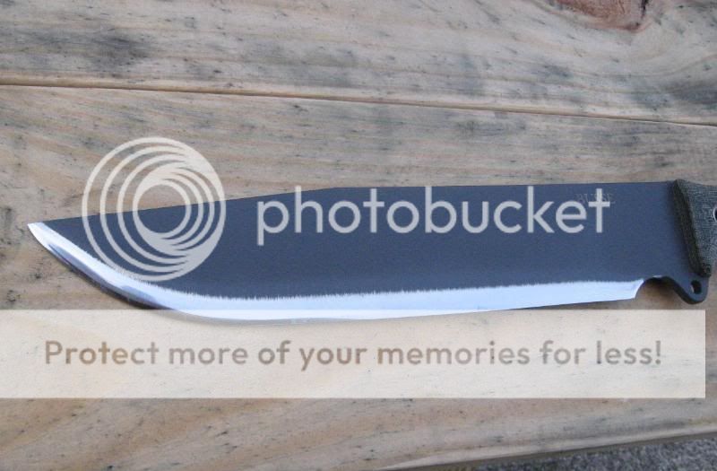

That third pic is really good, you can see how high the reprofiling goes. I might have to wait till spring to strip and reprofile mine.

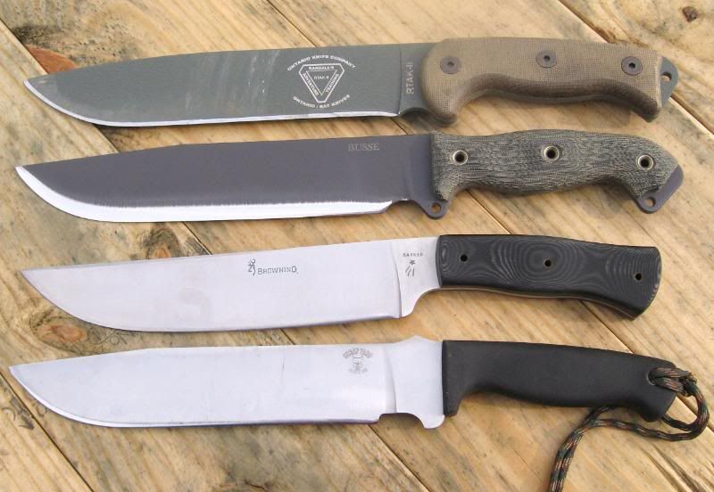

Can't wait to see the competition!
Compared to some of the true artists on this forum, I am a hack. But thanks anyway. I go more for function than looks. I cleaned up some of the deep 40 grit scratches, and the BW is ready for action.
It may appear that the Busse is ground thinner than the others, but it really isn't. Both the DFLE and RTAK are flat grinds, so I didn't have to remove as much steel to get the same edge angle. The Browning is full convex ground from the factory, but it is a flatter grind than the Busse convex.

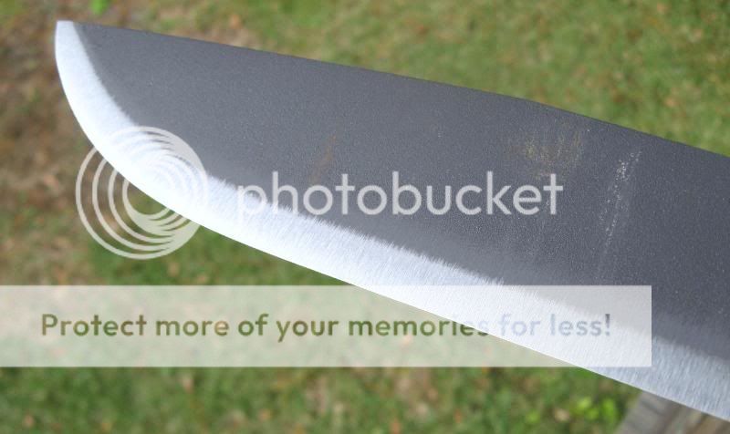

It would definitely look better stripped and satin finished. Leaving the coating on and grinding that much looks funky. But it works. I tried to get some better pics of the edge just before dark.
Horned, how long does it take you to put an edge like that on a blade of that size? It looks really nice.
I lose track of time when I grind, but I would guess two hours. Maybe a little less. I take breaks from it. It requires a lot of concentration for me.

Your blade was flat ground pretty thin anyway, so it only took a few minutes. I could feel a lot of thickness behind the abrupt edge on this one. I tried to blend the factory convex grind to the very edge (zero edge) for no secondary bevel.
