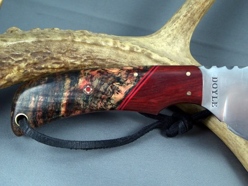

Bloodwood can be stabilized, but I was told it was one of those woods that does not HAVE to be. I've used both stabilized and unstabilized and the only difference I found was that obviously the stabilized polishes better. Here's a pic of a knife I did a few years ago w/bloodwood bolsters:

Matt, what's the other handle material?
The other handle material is black dyed boxelder burl. Boxelder sometimes has red streaks in it, when it is dyed another color (ie. black) the red does not take on the color of the other dye.
