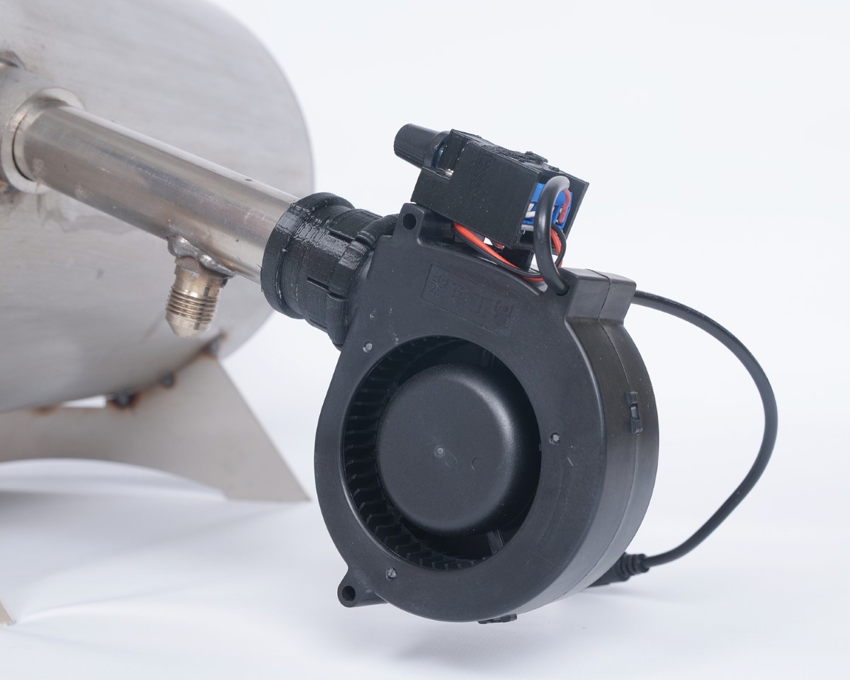

I had not used this forge since building it as everything I forged ( up to 13” knives), would fit in my Atlas Mini. Now, I need to put the built one to regular use. Is there any way to reconfigure the pipes to cut down on that weight and bulk asis, and would this forge be considerably safer, or just a little safer with the blower above everything Vs the current location?

I would NEVER put a blower above a forge. You will create a draft when it shots off. This will draw the hot forge chamber air up through your piping and through your blower. With the blower lower then the forge you get a cool air draft through the blower when shut off keeping it cool. I like your set up
I agree with JT. The blower should be lower than the port. The old worry about propane drifting down the manifold and exploding at the blower motor is pretty silly. It can be solved easily by a solenoid valve if it really worries you.
Thanks JT and Stacy, I could not remember reading about that when I was building this but as I was looking around old threads to refresh my memory on this build I came across a couple of threads mentioning the blower should be high so I thought it best to ask before proceeding.

I know, the 178 CFM Dayton blower is the standard, and has been for decades. However, you can actually go with a much smaller CFM. I've built over fifty Graham Blown Burners, with the 30 CFM and electric control. I really like the dial instead of a gate valve. I do need to look into longer, flexible supply lines, per a previous conversation with Stacy.
100k BTU only requires 15.38 CFM air flow. A 30 CFM blower will provide this with and handle the back pressure adequately. Actually, up to about 140k BTU out of the blowers that I use.
