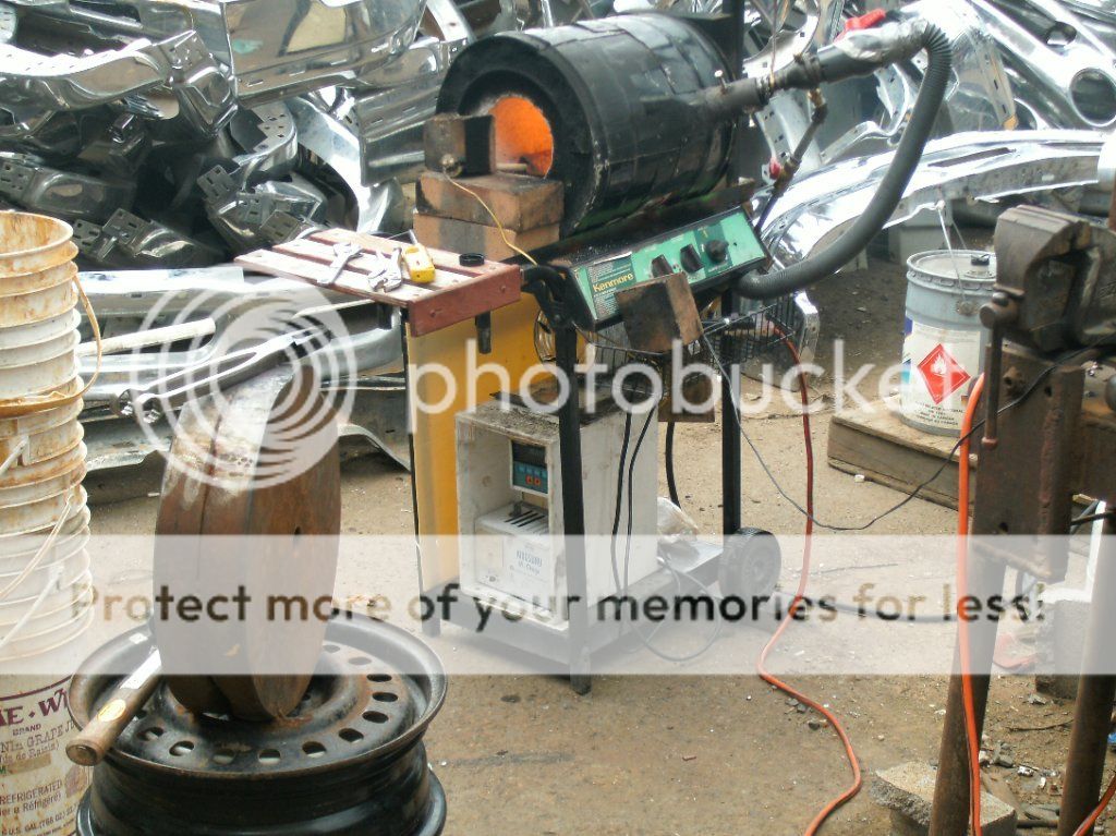

So I'm planning to build a Hi-Low pid controlled blown propane forge. My forge body is planned to be a 30# freon tank with 2" of inswool and 1/4" or so of satanite for reference to my application.
I have read thread after thread about blowers and have heard all sorts of recommendations. From what I understand I'm looking for a 110/115V blower in the 60-100CFM range and capable of providing it with a static pressure of .30" (correct me if I'm wrong) and using two fan dimmer switches for two speeds. A personal preference would be something that will be easy to connect to a 2" pipe flange (or does it not matter?). Some options I've seen are:
http://www.blacksmithsdepot.com/products/forge-fan-fuel/forge-blowers.html
The 164CFM unit looks like the only one with a flange and from what I hear might be overkill? A smaller one might work better but which one?
I was also looking at this one, a Dayton 1TDP3 PSC. It has a flange that should make for easy mounting, hits 66 CFM at .30" but has a max inlet temp of 104F.
http://www.ebay.com/itm/DAYTON-1TDP3-PSC-Blower-115-Volt-/321119284155?_trksid=p2054897.l4275#ht_2775wt_1255
And then I see recommendations for bounce house blowers but A) I haven't seen any specs for them and B) I have no idea how I would mount it.
My other question is about safety. My father-in-law who is helping me out big time was thinking it could really use some safety features so no one gets hurts. One idea we had was an extra solenoid connected to an e-stop between the regulator and the burner. Another idea was a backflow preventer like on a welding setup so the tank can't ignite. An idea he had was buying a used propane heater to use the parts out of like the ignitor, flame sensor, controller, etc. That idea went over my head so I wanted to ask the experts. What safety features should we be considering???
