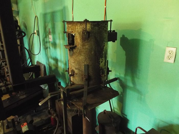

This is a 12" pipe split lengthways with an added 6 inch web to increase the welding.

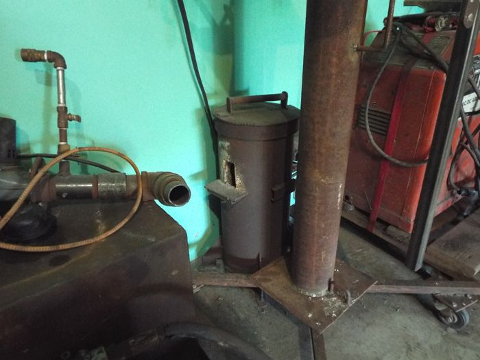

An 8 inch for little jobs and when I go on the road and do demos:
And here's a straight 12":

after the forge is thoroughly heated I don't think there will be any difference in heat. I do think it will be more even throughout the forge. My vertical forge is an old pottery kiln that I re purposed by adding an additional layer of brick to the inside. I left the hinged door on the top thinking that if something dropped inside it would be a simple matter to shut down open the lid and retrieve my part, shut the lid refire and keep on forging. WRONG At welding heat as soon as you try to open the lid there is a searing heat that escapes the forge. you can open the lid with a long bar or a long pair of tongs, But then it is nearly impossible to get close enough to the forge to retrieve the part that fell into the forge. The only way that I can manage, is to put an old nomex coat and face shield, from my days as a fire fighter. Even then my welding gloves get smoking hot and if it takes more than about thirty seconds to get my part, the gloves are ruined and too hot to keep on. if the part is left in the forge lonng enough for the forge to cool so you can reach in the part is ruined, with huge grain and lots of scale.
My setup is almost just like Karl's, good combo. I made this one just for heat treating blades, great control

Got it built, 2" of wool, coated twice with satinite, bubble alumina on the bottom with a drain hole. I ran it last night for 6 hours, mostly playing, stacking and welding bits of wrought iron and welded and forged another hawk.
Here's what I'd do different next time. Put a 1/2" thick fire brick into the openings to protect the wool there(going to do that next time I go to the brick yard), and make a door on the bottom. I dropped the hawk 3 times while doing the finish forming. Luckily I my main opening is 5"x8" closed off with fire brick. I just shut the gas off and blower off and used a long hook to reach in and grab it.
After running for 6 hours there is some minor damage from flux, but way way less than I'd have gotten with my horizontal forge.

Nice! I like those big doors. Seems like you got good welding heats with it too.
I used bubble alumina on the wool inside the doors, a thin brick might be nicer.
For sure getting good welding heats, this was the first time I welded a hawk and didn't have to put a tack weld in the eye to keep it from splitting during drifting.(earlier hawks were forge welded, but the drift sucked heat fast and the weld was a weak spot) One time I shut down the gas and left the blower running to get the hawk out of the bottom and there were a few sparks coming from the wrought iron, didn't spark when gas was running so I guess it was a reducing flame.
