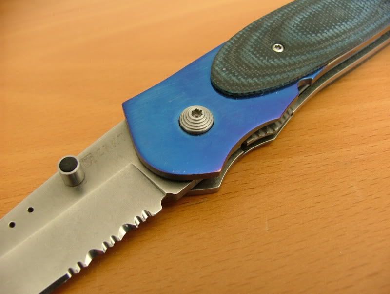

I don't own a Seb, but what are the thumb studs made out of? If they're titanium, you can make them more blue yourself with three 9 volt batteries, some cola, and some wire. The electricity combined with the phosphoric acid in coke makes titanium oxidize. For those that may not believe me, I had someone doubt the theory, so I tried it and indeed proved them wrong! It works. If the thumb studs are not titanium, well, good luck. I don't have any other ideas if it's not titanium.

Woah interesting.... they are titanium and the colors are anodized. I've seen it on the CRK DVD, but I just didn't know if I could change anything. Right now it's at about 20V and I'd love it to be around 25V on that scale.

I anodized a cheapy CRKT knife that I have and it came out very blue. I used three 9V batteris, so 27V. It seemed that the finish on the metal affected it a lot. With a semi polished finish I got the best results. I'll post a picture or two when I have some time today so you can see how it looks.

You can get nearly all those colours with just heat. I also find a the "heat finish" to be
much "tougher" than an anodised one. The oxide layer must be thicker or something.

I'm not sure why the heat method finish would be tougher, but it shouldn't be any thicker. The colors vary as they do because of the thickness of the oxide layer. A certain thickness reflects a certain color. Therefore, you can't have a thicker layer of the same color. I'm not saying that the heat method doesn't create a tougher finish, but that the thickness is not the reason for it. I like that with the voltage method the color can be controlled more than with heat.
Yup, I know what you're saying, the reflected colour does indeed depend on the depth of the oxide layer but I couldn't think of a better way to put it :p.
I do quite alot of work with Titanium and in my experience the heat finish is much harder to sand off and takes longer to "wear out" than the anodised one.
You do get much better contol of colours and a more uniform finish with "electrical anodising" but with a bit of prctice the heat method is better IMO, especially for small pieces where it is much easier to get the whole thing the same colour. Heat is also great for getting a multi coloured effect, like I used on this Ti pry bar.
