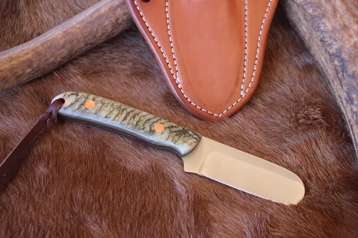

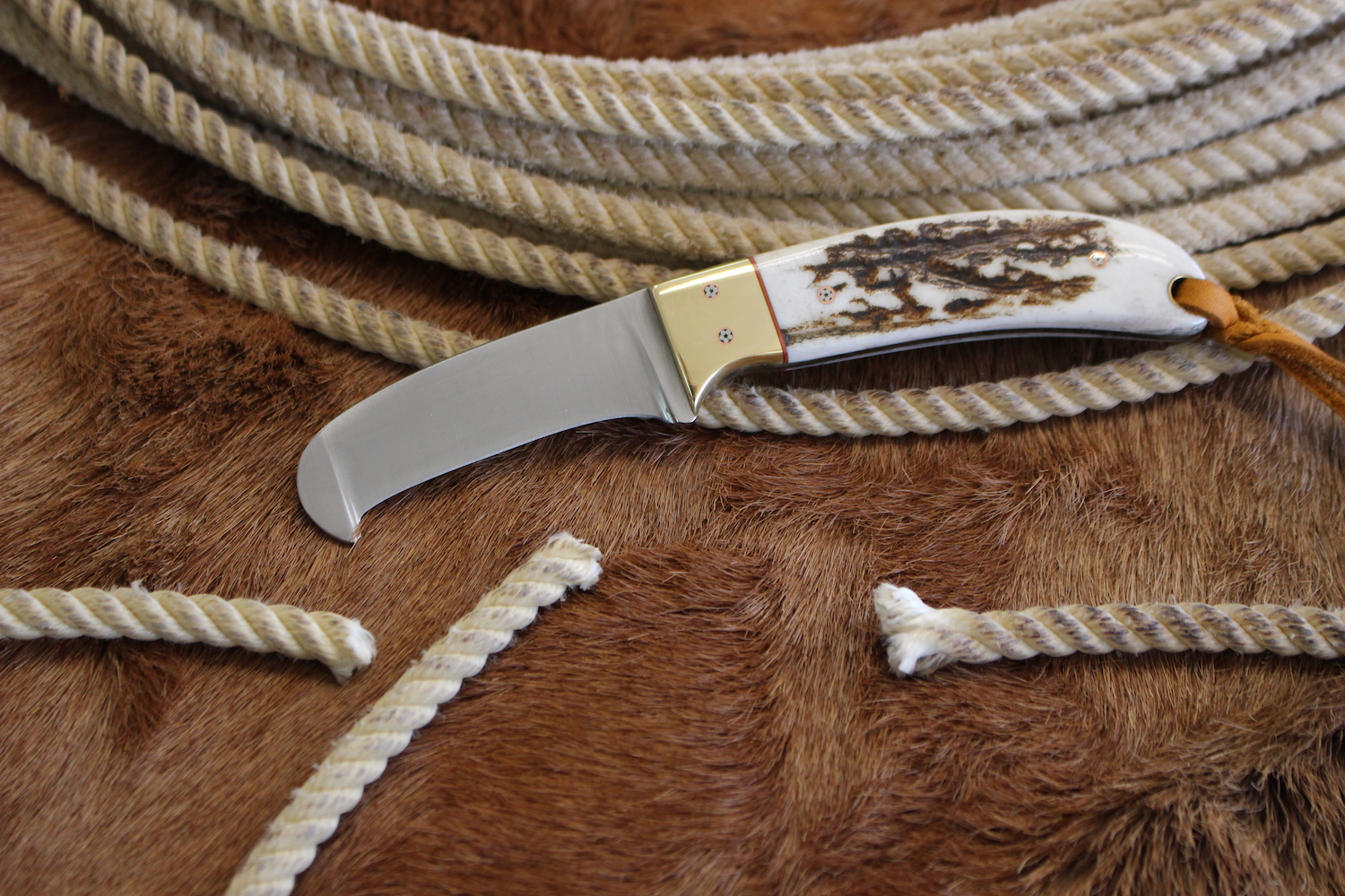

That would be a very tough grind. I've done some of these:
I call it a Packer Safety Knife. The original was designed and commissioned by JR Rodeo judge. He wanted something that he could jump in with and start cutting kids loose if they got hung up. Knowing that there are a lot more mule draggers (packers) that face wrecks with lot of rope and flailing large animals on a daily basis, then there are JR Rodeo judges, I named it The Packer Safety knife. Even still these are very tough to grind too and the last one I did is out in my shop trash can right now.
I make these too. These are Castrator knives. They are used to castrate cattle in chutes or on a calf table where there is a possibility of the left hand getting kicked/knocked back into the right hand holding the pointy knife. Many have said that they would make excellent skinning knives for that exact reason, no point. Maybe something to head your client towards if the other doesn't work out. So the last ones that I did of this style made it on the bus to Peter's HT. The last one of the Safety Knives got kicked to the curb.

Thanks guys I agree that its largely the design thats complicating things and something simpler would be one solution. I actually read Horsewrights thread the other day and thought that both designs looked easier to grind than the awful thing Ive assigned myself and would lean toward something more like that if asked to do another, but the customer is kind of set on the design so Ill peservere and see what my frustration tolerence is like.
Still not sure how thick to keep the flats at the tip to prevent piercing as the design is similar to Horsewrights packer safety knife but much less height at the tip and more recurve.Good to know Im not the only one to mutter a few profanitys while trying to grind one these though.
