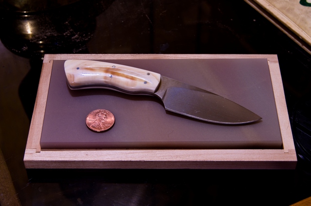

I went to the below translucent stone several months back. And it will put an unbelievable edge on a knife.
At first I wasn't going to use it because, I doubt I will ever find another one like this, but changed my mind and started using the other side of this one.
Lots of folks will tell you " oh it takes a long time to sharpen a knife on one of those." I am here to tell you, No, it doesn't.
I've taken a Bohler N690 blade from dull to wicked sharp in 10 minutes on the below stone. Granted the knife wasn't beat into ice or used to try to slice concrete and the edge wasn't rolled into a double.
Once you learn the art of sharpening on a fine stone, you won't go back to the gimmick items.
Stones like the one below are not cheap. I think I paid 110.00 for this one. I wouldn't part with it for 500.00, because, Number 1 : I most likely will never see another one like it, and number2 : Some of the edges I have put on knives with this stone make it worth its weight in gold , to me.
Sure there are many items that will get the job done, but if you're into knives and go to a truly high quality stone.........there is no going back.
The other thing about these types of hard translucent stones is, you won't wear them down or dish them out. They will last several lifetimes.
The last stone you will ever need.
Where on earth could one acquire a stone like that? ? ?
Its absolutely gorgeous.
I have a really sweet jade crystal stone that im afraid to use too. Just too purty!
So recommending a stone which cannot be bought nowhere and takes month to master is the solution for a guy having problems with his sharpmaker?
