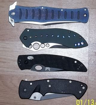

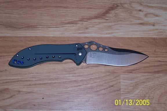

Got my new Skirmish in the mail the other day, wanted to share some of my findings and lots of pictures!
Per Benchmade, "The Benchmade 630 Folding Knife has a stylish blade formed from S30V stainless steel with ambidextrous thumb holes. The titanium handle is well balanced and contains the monolock locking mechanism and a pocket clip. Benchmade knives are covered under a limited lifetime warranty. Blade length: 4-3/8". Overall length: 9-3/4". Closed length: 5-1/2". Weight: 6.8 oz."
There has been some reviews stating how huge the knife is... the funny thing is, closed, its not so big. When you open it... suddenly it is pretty dang big! Here's shots of it closed and open, next to some other well known knives for comparison. The handle is shorter than an AFCK!

OK, what's great about the knife? Very well made, locks up beautifully, no blade play at all. Closed, the blade centers nicely in the handle. Solid, very solid. Handle is very ergonomic, feels great, much better than the CUDA Maxx feels in the hand. Much more secure and comfortable. Blade is wide and flat ground (basically) and cuts very very well. Came shaving sharp from the box. That recurve shape really works, as you pull the knife through the cut, the belly is really forced through the material. Shaved wood, slashed vinyl cloth, cut food wonderfully. Excellent self defense knive. The tip is rather blunt, especially as compared to the needle point of the Maxx, but that won't really effect a thrusting move. Its sharp enough. Maybe you won't be able to get a splinter out with the tip, but oh well... I did the whack test, came through fine, also the "wrap blade in 12 layers of towel and manually try to defeat the lock" test (don't try this at home). This test popped the blade of my Benchmade Eclipse instantly... But the Skirmish held tough. I have confidence in the lock. But about the lock, see below...
What's bad about this knife? The pocket clip sucks! Wait... more emphasis... SUCKS! Its like a big shiny spoon! That clip came off within five minutes of arrival... it leaves a small slot in your handle when it comes off, but its not too terrible.... The finish seems a bit delicate. Like a coating, rather than the durable anodization of the Maxx. Its already picked up a ding or two just from my not so careful handling.
The little colored dots concerned my before I got it but they are not as bad as you'd think... they are metallic colors rather than poster paint colors and so you don't really get the feel of "gee this is my Rainbow Nation knife..." They're not so bad.
I do have to say that this is the first knife I've taken a file to on the first day I owned it. If you look at the photos where the knife is closed, there is a shoulder of the blade that sticks out. Its cut out a a perfect 90 degree angle from the side of the blade... and its sharp! So I "melted" it with a diamond file and fine sandpaper which I laid on a soft surface. Just a little... but now its not sharp any more.

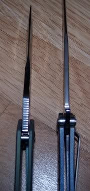

The other thing that might be an issue is the thickness of the lock bar where its cut out to bend it in. Its very thin. This makes it a lot easier to open than the Maxx... but could be a structural weakness. Here's a photo comparing the thicknesses of the lock bar cut outs on the two knives to show you what I mean.
The blade is really thick, which is good and bad, depending on your application. Here it is compared again to the Maxx:
