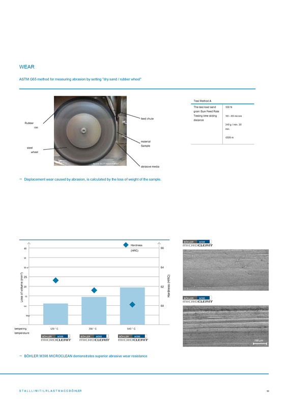

C - 2.7%, Cr - 20%, Mo - 1%, V - 7.2%, W - 0.7%, S - 0.5i%, Mn - 0.5%

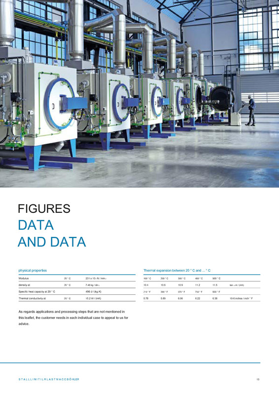

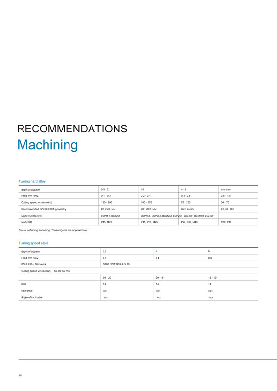

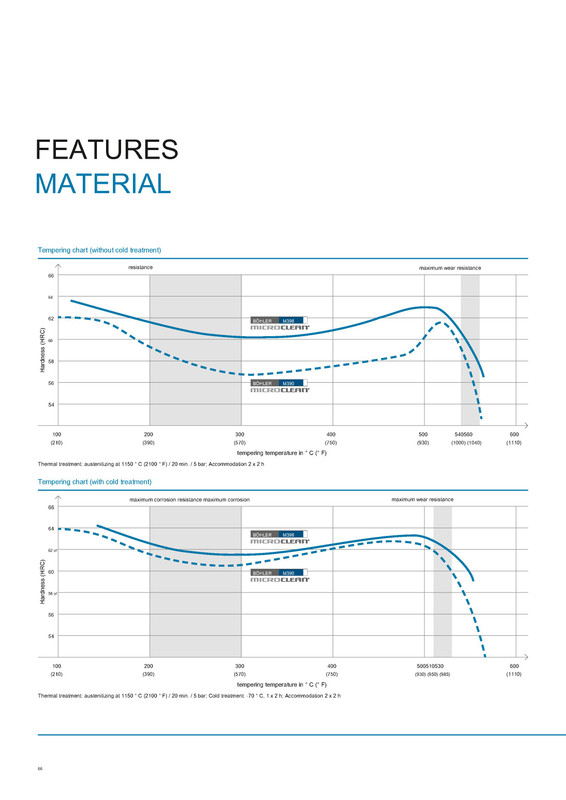

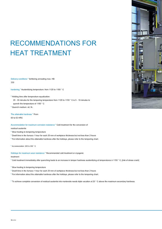

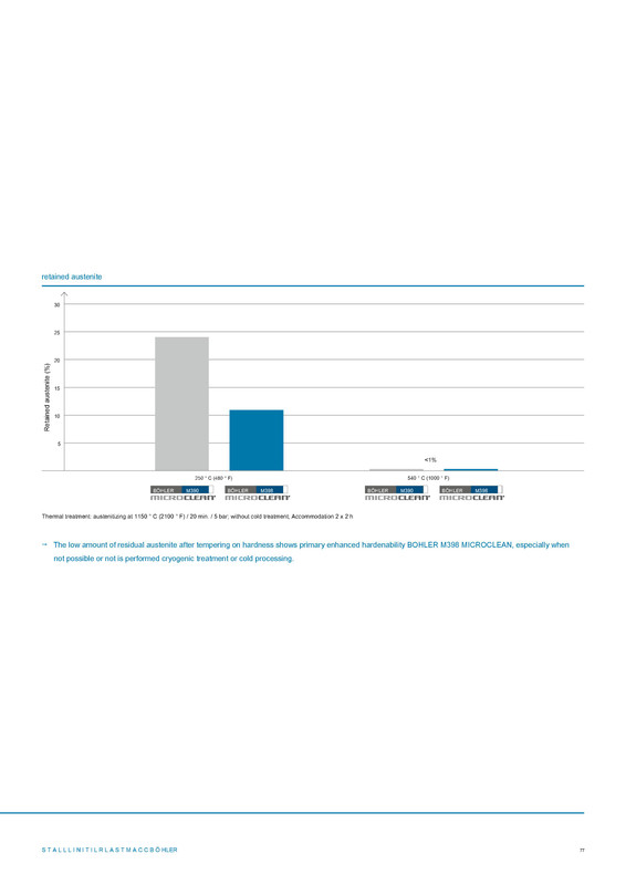

-Link to the pdf converted to English using an online translator.
https://www.scribd.com/document/407854724/Bohler-M398-Ru-en
-The original russian pdf link from Bohler.
http://www.bohlernn.ru/media/Bohler_M398.pdf

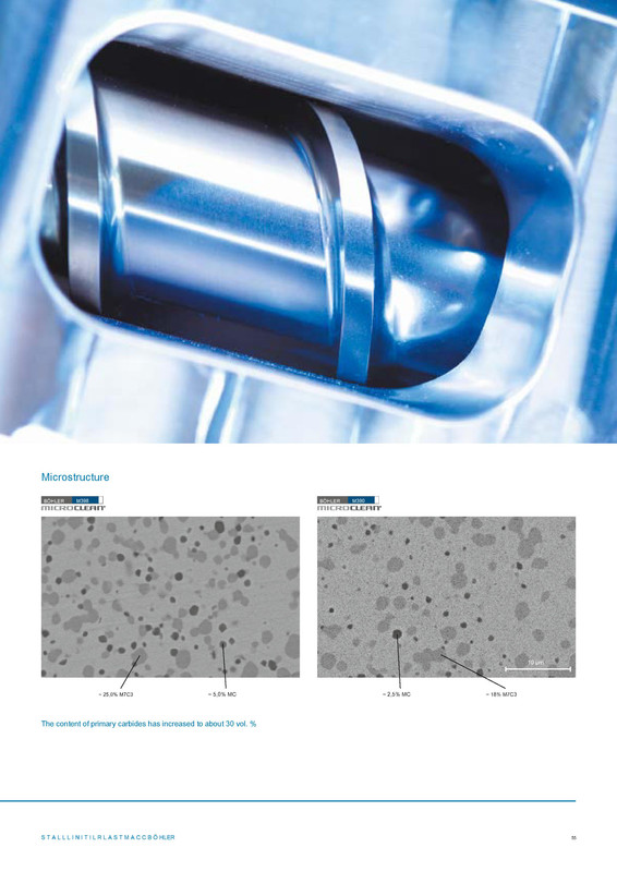

but personally, I just wouldn't use cast iron to make a knife... even with pm tech
it's like zdp189 but with 7% vanadium added - which of course makes it really nice wear resistance wise... it should put zdp189 to shame

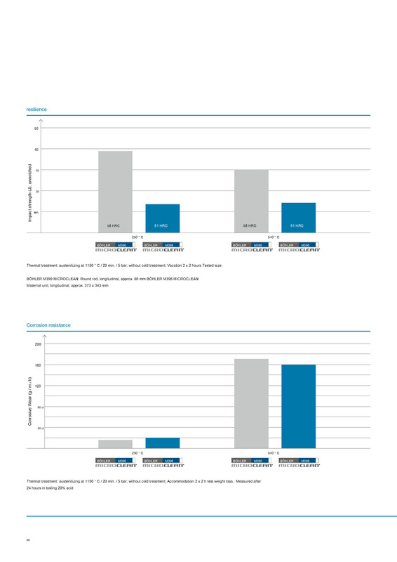

but it still suffers the cracking / lack of toughness issue, which in real world use is just a real pain

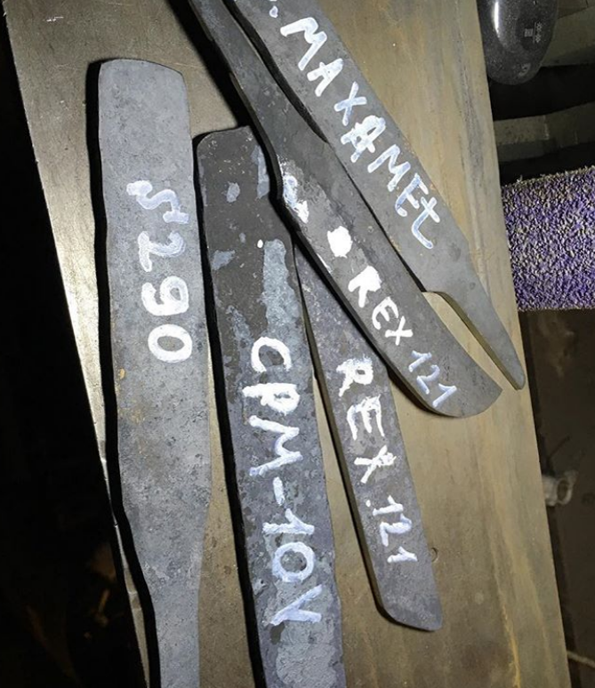

same technique as Denis Frolov
Very interesting, looking forward to writing about it. Looks like the toughness is very poor. I’ve been waiting for a new steel to write about.
in that video, if you pay close attention, it took him 50+ heats of the round stock just to get it to the usual starting point of a bar...
imho, that's a bit extreme
I’m sorry for my ignorance, but Bohler can’t forge this steel to sheets because of the risk of cracks, but this gentleman can forge it to a knife shape with no cracks?
It's stated that Bohler can't "cold roll" this into sheets. As the name implies, cold rolling is done at the end of the process when the steel is cold, in order to form the bar stock (I think there are a few other reasons for doing it as well, I barely got a passing grade in my basic materials course so I'm definitely not an expert.) You can't really compare it to forging since they're done at different temperatures, and it would probably be cost prohibitive for Bohler to forge all of this into bar stock, especially when all of the "areas of use" in the company literature involve the use of round stock.

that is really quite interesting, it seems that kuznec is talking about dealing with microfractures as a feature of blade forging, to make it stronger by avoiding the build up of fractures internally by using 3 key elements:
1. very weak hammer strikes, don't try to move a lot of material with big swings
2. very low temps
3. acorn shaped hammers (I guess a smaller ball peen hammer should work) as this will not allow fractures to form, giving steel a direction to move which does not induce build up of fractures
He seems to be making the point that doing all this will result in a steel which is less dense AND stronger?? (this part I might not be understanding)
it would interesting to hear Larrin Larrin talk about this, from a more scientific perspective

I do have an article on forging of steel coming out today. I'm not particularly interested in whatever he is saying about changing the density or strength of the steel, however.

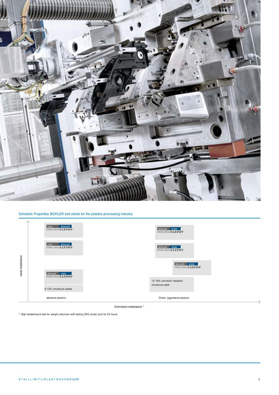

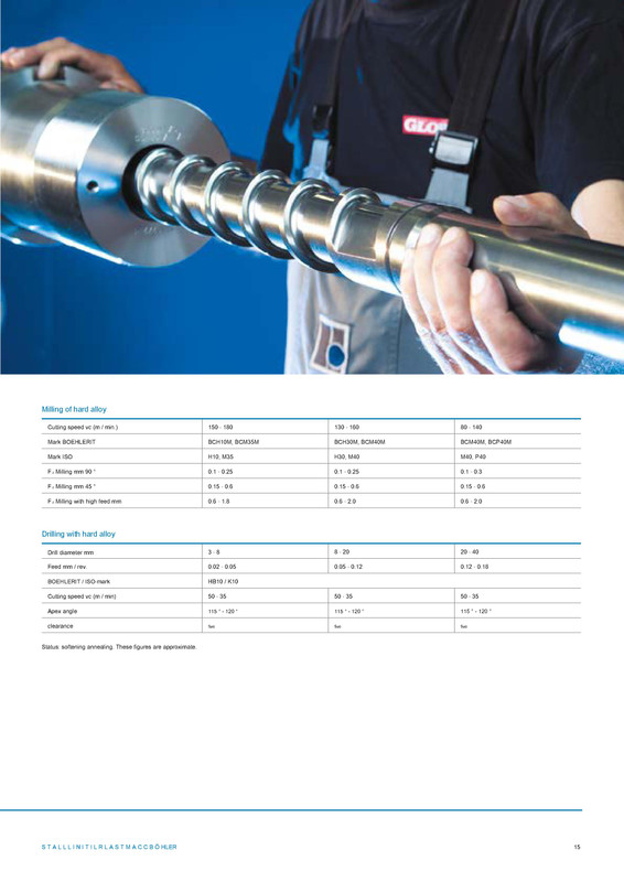

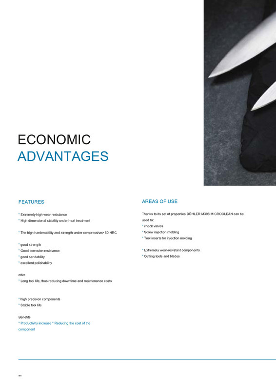

So if you are maker of screw auger plastic/ceramic extruders or screw fed plastic molding machines, we have the steel for you. I love the tease in the Bohler brochures, showing knife blades, even knowing they are not making sheet stock at this time. Move over Maxamet, M398 is a coming.
