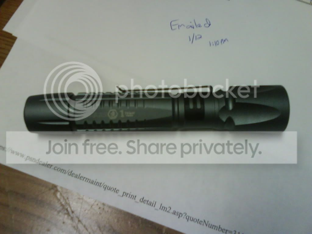

Here are pictures of it after everything it has been through. Sorry for the crappiness of the pics. My camera is down so I had to take these with the phone, but they show how good of condition the knife is still in.
