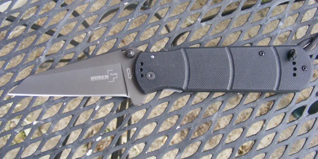

Left side...

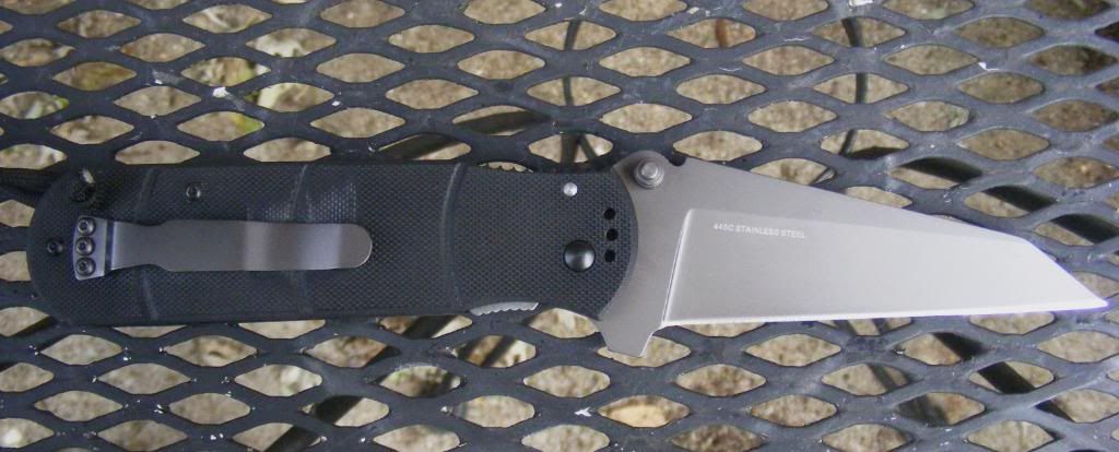

Right side...
The Handle: The G-4 is 5" closed and 1/2" thick (not counting the pocket clip). It's beefy. The handle scales are black G-10, and they're textured quite nicely; not too aggressive and not too slick. I did find that when inserting (or removing) the G-4 from my pocket, the G-10 would snag and make pocket inertion or removal difficult. I solved this by removing the pocket clip, lightly sanding the are where the clip contacts the G-10, and reinstalling the clip. You'll see this sand mark in the photos; they're my own doing and do NOT represent how the knife comes out of the box.

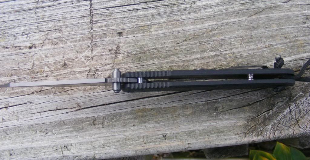

The G-10 handle scales are held on with four (two on each side) black Torx (T-6) screws. Underneath the scales are full stainless steel liners. The right liner acts as the lock, and it's jimped nicely.

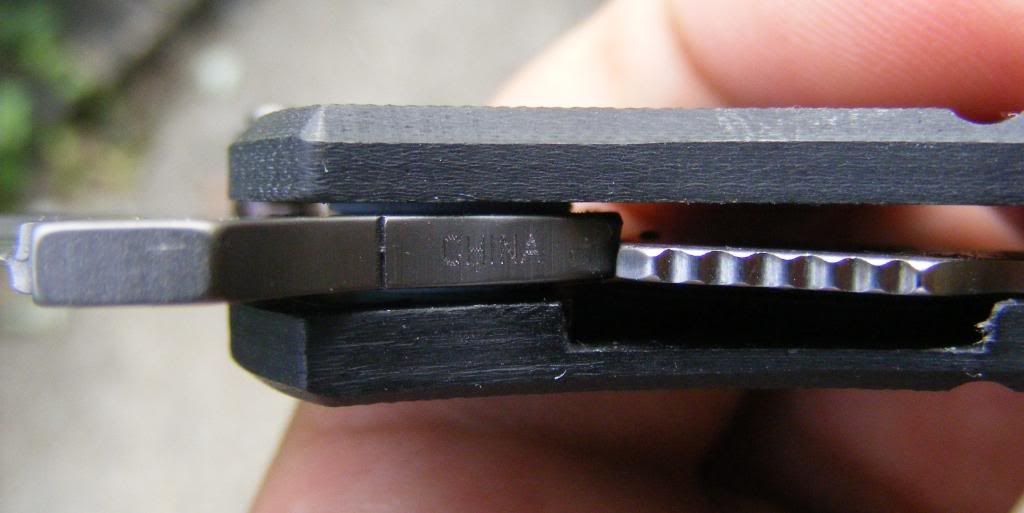

Also notice on the photo above the word "CHINA" on the blade base; that's a good place for it, in my opinion. Country of origin is required for U.S. import, and I like that it's not on the blade itself.

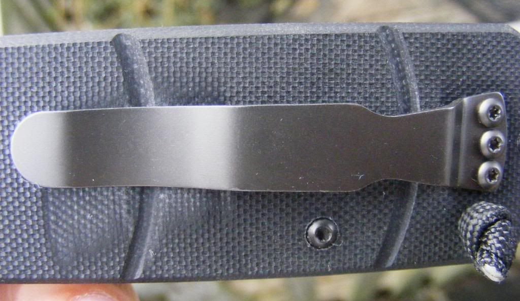

The pocket clip is a gun metal grey color, and is adjustable in any of the four corners; tip up or down, left or right-handed. It's held in place with three Torx (T-6) screws.

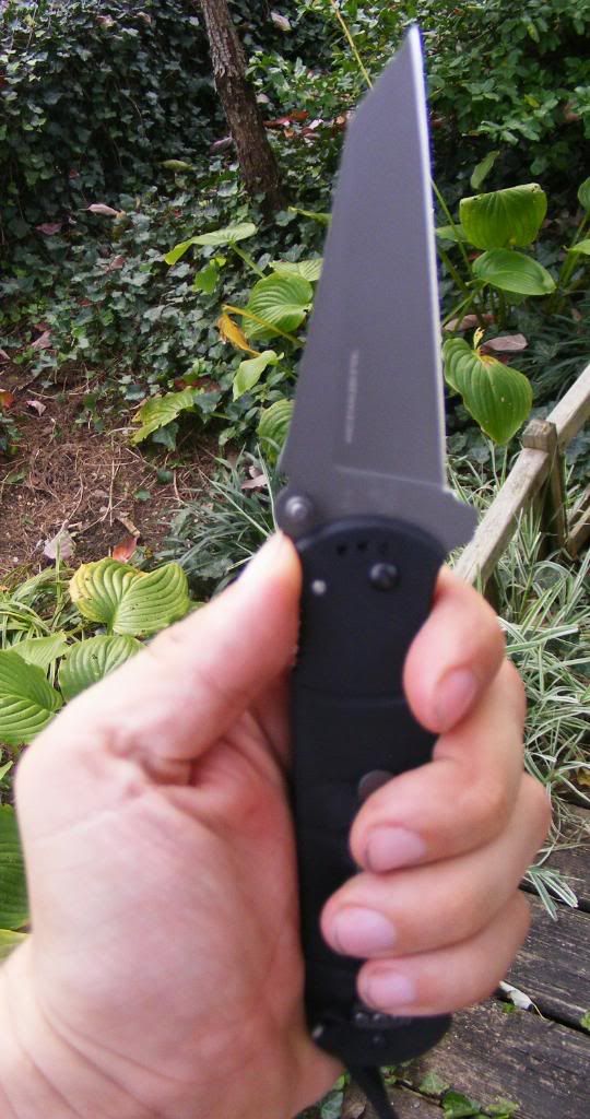

The G-4 rides deep enough in the pocket not to worry me (or the sheeple)...

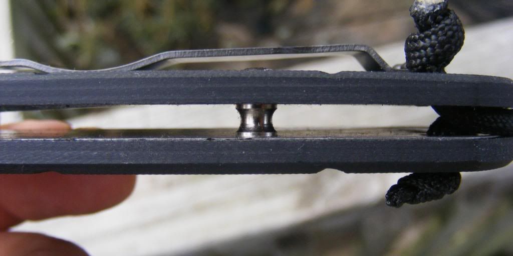

The back also has those nice "hourglass" pillars that I prefer over the standard flat spacers...

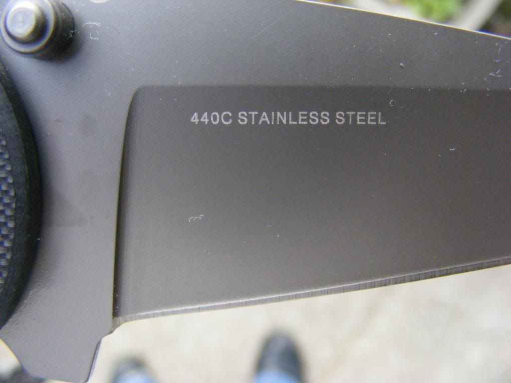

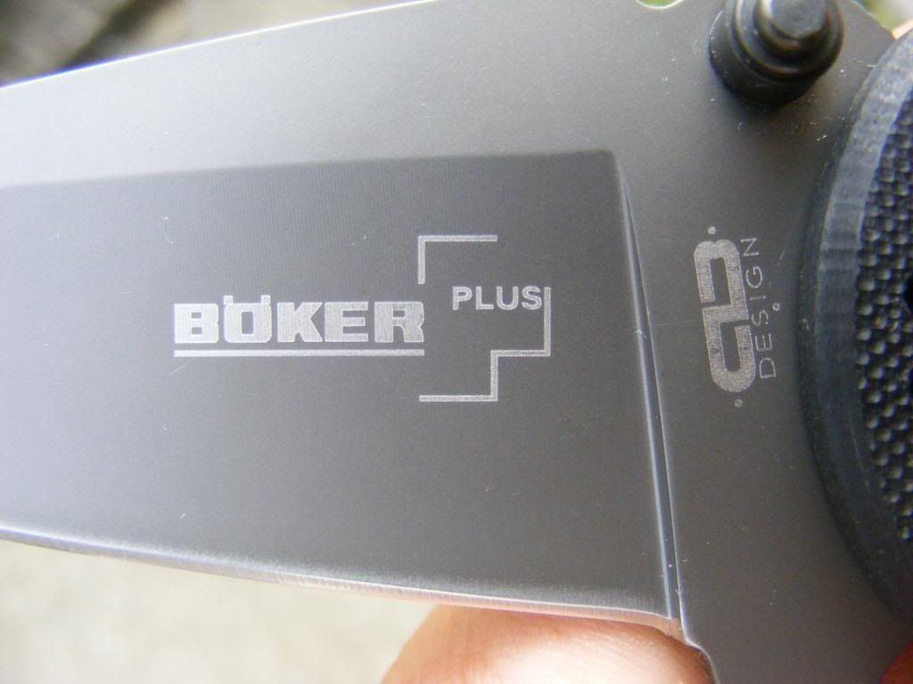

The Blade: The G-4's blade is made of 440C, and is 4" long (3-3/4" cutting edge). It's 1/8" thick and has a nice gun metal grey color. Markings are as shown below.

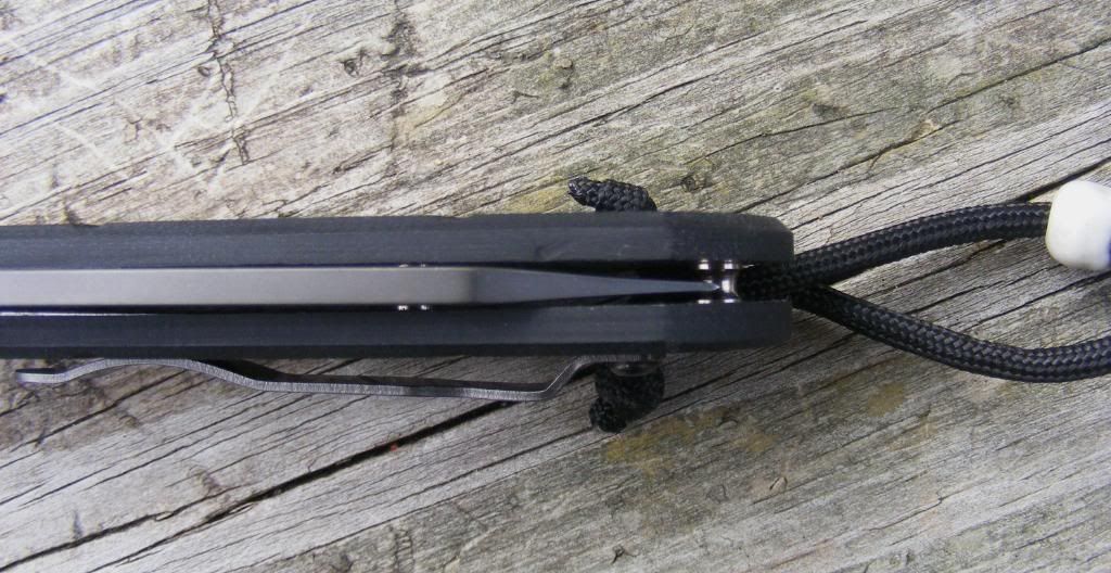

The blade, when closed, is pretty well centered...
