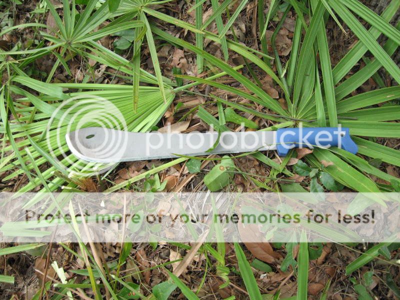

A lot of outdoorsmen like bolo machetes. They are shorter than traditional latin-style machetes with a wider blade near the tip, which makes them good choppers and diggers. Today, I did a comparison of some of the bolo machetes available. Left to right, we have the Cold Steel, Condor, Tramontina, Windlass, and Becker. The Becker is no longer being made, but there are still quite a few of them out there.
The Windlass and Becker are on the right. These are heavier and thicker than the others, being 3/16" thick. The other bolos are much thinner, less than 1/8" thick or about 2.5mm. The shortest are the Tramontina, Becker and Windlass with 14" blades. The Cold Steel is the longest with a 16" blade. The Condor has a 15 3/8" blade. So all these are longer than the 12" camp machetes, but shorter than the traditional 18" to 24" blade machetes.
To keep things as evenly matched as possible, I put a good fresh convex edge on all of them, except the Condor which came with a polished convex edge.

I really hate this handle. The steel is 1055 and it takes a good edge. Next I used the Condor. It is just a bit lighter than the Cold Steel at just under 16 oz. Steel is 420HC German stainless. The handle feels much better and it slashes well right out of the box. Not as quick as the Tram, but not bad at all.

Overall, I'd say the Tramontina did best in machete work, with the Condor a close second. But I had to do a lot of work on the Tram to get it to the performance level of the Condor. Next up: chopping.

Overall, I'd have to say that I'd prefer using either the Tramontina or the Condor. The Condors are the best out of the box machetes I have used so far, except possibly the BRKT, which isn't in this review because it isn't a bolo.
