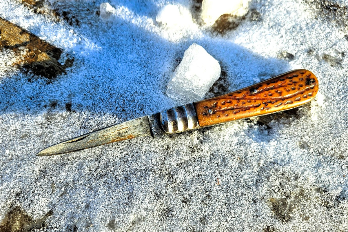

Here is a Old Sheep Castrator that came apart like a peeled banana, because too much was removed from the bolster/pin!! (Lower Knife obviously)!! Obviously, you must be careful!!
The pin you see is a "patch"!! It was later replaced with a flush pin!!

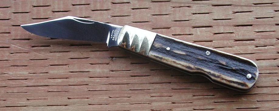

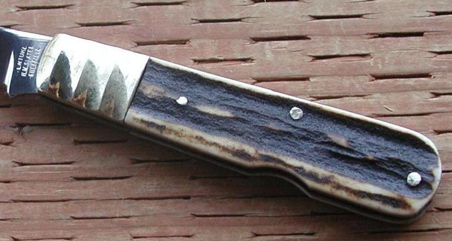

Here are 4 from Hiroaki Ohta and one from Brent Cramer. I can't tell where the pins are but all of these seem, though not used much, just fine.
Sorry, not the best pics but I'm headed out the door....
Thinking about it, my knives with Rat-Tail bolsters seem some of the strongest with no hint of play. Seems born out by the interesting pictures many have already put up.

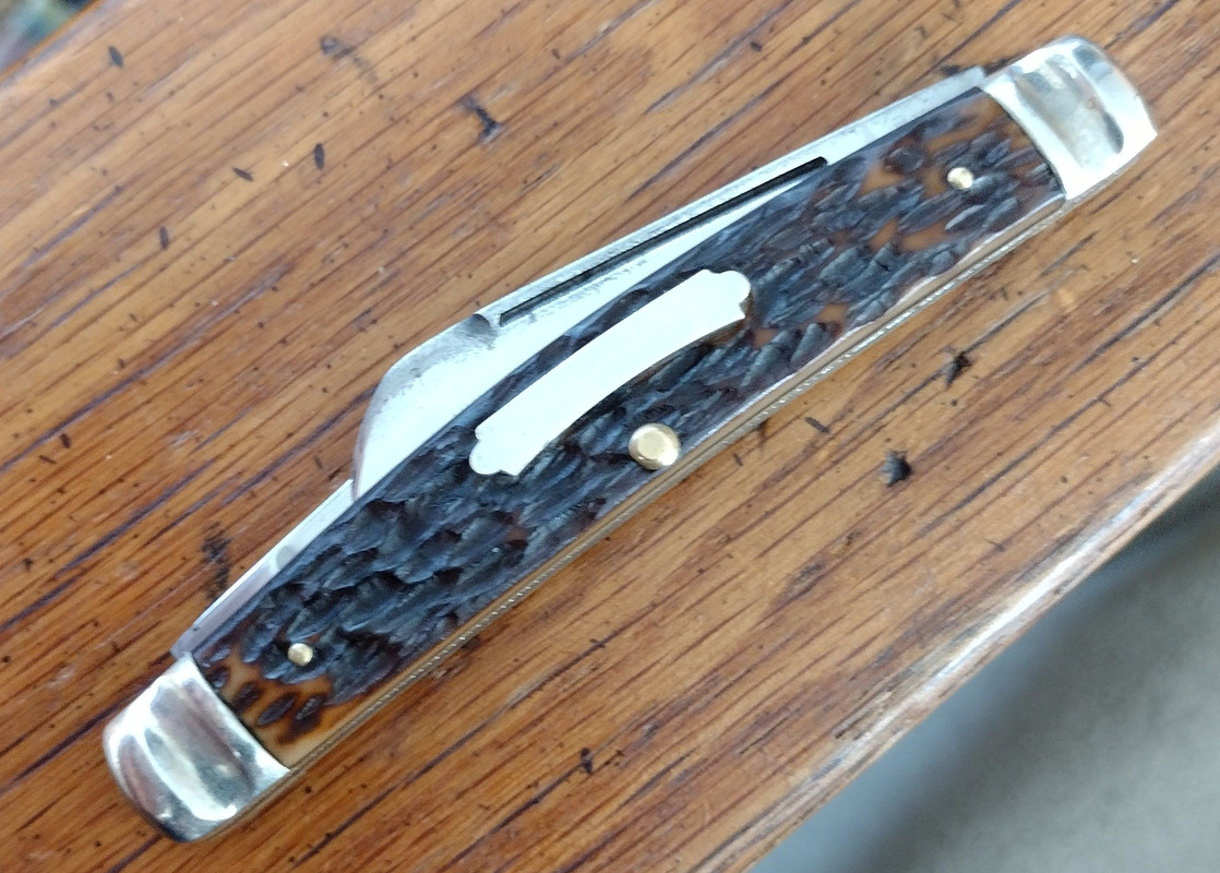

Here's a knife I had made by artisan Jérôme Latreile, it's his rendering of an old but rather neglected pattern called the Gouttière. Sent him an inexpensive factory knife to use as a pattern model. His answer was to use an exposed pin and I think it works beautifully and rustically with this bolster too. Gouttière means a rainwater gutter and the knife is called after it due to its distinctive bolster being reminiscent of guttering on a house.
A production Gouttière from the maker GR. It's a tough, even coarse character Olivewood slabs, stainless bolster & liners, a big chopper Sheepfoot in carbon. Easy to open but mind your fingers closing it Nice action, no play or gaps and no sign of a pin or ghosting through the bolster. This may be due to using stainless bolster and not nickel silver?
