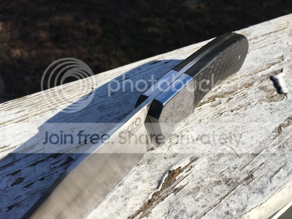

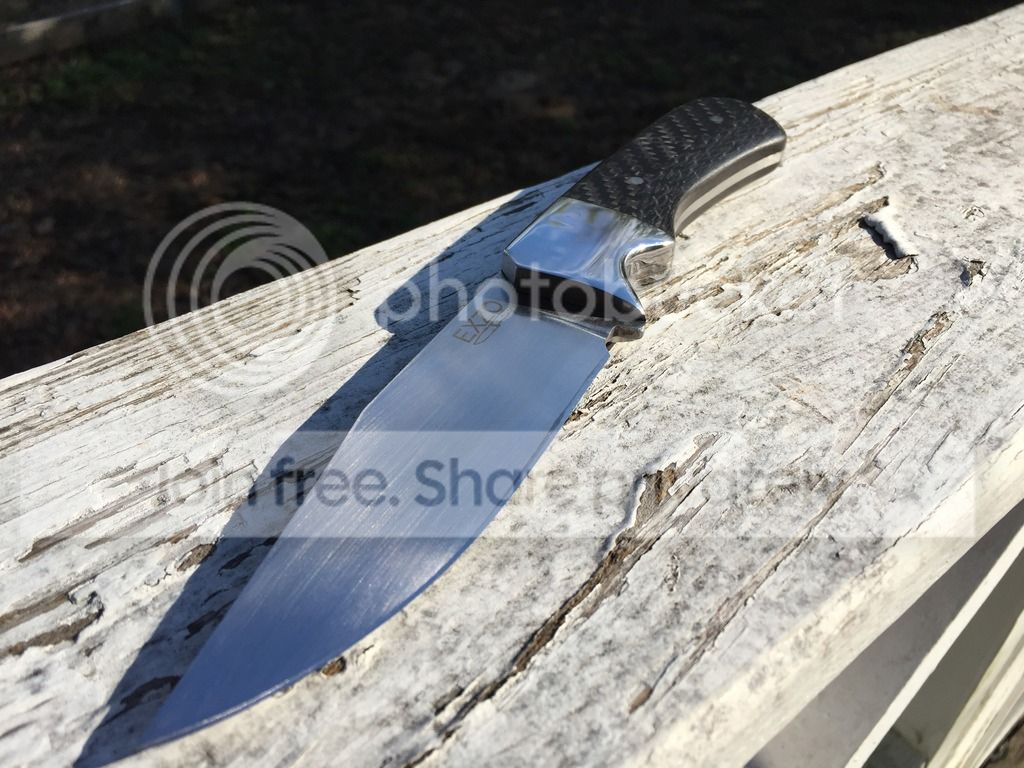

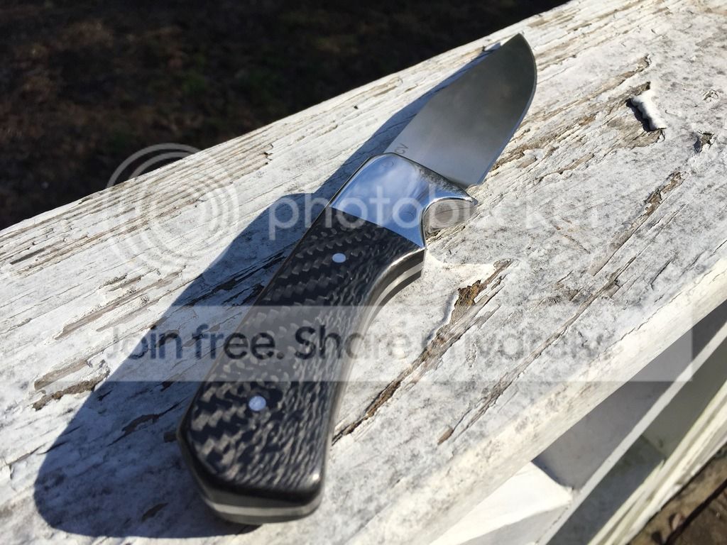

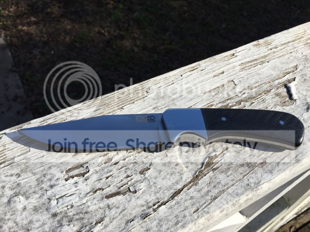

I recently made the knife below (my first knife with a bolster) using 416 stainless for the bolster and pins. It worked out great. Polished up nicely, wasn't too bad to grind and shape. The only thing I really screwed up was allowing some epoxy to get on the pins/in the pin holes. Consequently, if you look close, you can see a ring around the pins. Most people don't notice it, but I do. I also didn't squeeze the bolsters down tight enough, so there is a visible line of epoxy between them and the blade on the spine.
I had a similar problem with my pins on my first bolster. As far as the visible epoxy on the spine, I hollowed the inside of my bolsters a small bit so it was easier to get the edges really flat. You might give that a try.
I use a lot of nickel silver for bolsters and guards because I like the hue it gets when aged...like 1920s motorcycles before chrome plating. I use a glove and hold my bolsters against a disc sander at 400 grit to get them perfectly flat before pinning them on. I also surface grind the ricasso of my blade and finish both sides on the disc sander before installing the bolsters. I fit them so tight that they require no solder ...a film of clear epoxy seals the underside. I don't worry much about water because I use stainless blades in the first place. Larry
