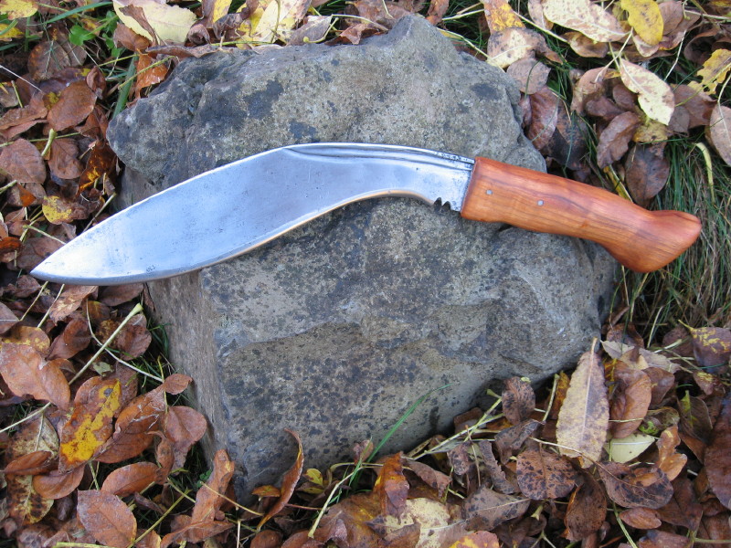

I put a handle on a Bhojpure blade without using a bolster.
The handle was shaped to fit my hand perfectly.

Looks pretty!
I was thinking of pins too but wanted to keep the historic blade as original as possible.
The traditional handle which I have is already profiled on top to hold a bolster there.
Maybe Ill make my own handle then I can do it like you. Your work is inspiring. Love the little details in your description. Drilling the pin holes after gluing, taping the drill holes so they don't splinter and so on. Very helpful!

I tried for as close a fit as possible, but making and progressively enlarging the blind hole (with my beginner skills) wasn't perfect. The finished hole was partially filled with epoxy, then when the tang was inserted, any gaps were filled and the excess epoxy came out at the top of the handle.
(I think this answers your question.)
