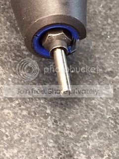

This really got me out of a jam yesterday so I thought I would share it. I was working on a small fixed blade with nickel silver bolsters and pins. Ended up with three out of the four pin ends showing in the bolsters even though I thought everything was prepped correctly and peening the pins seemed to go well.

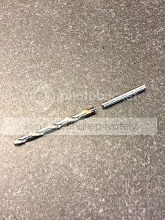

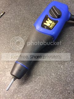

I didn’t want to pull the bolsters so I grabbed my cheapie electric engraver and an old 1/8” drill bit. Cut the shank off the drill bit with a Dremel and rounded off and polished the shank end in my lathe. I put the polished shank in the engraver and used it to work over each of the visible pins in the bolsters. A quick sand and polish and the pins were invisible. Saved me a bunch of time and frustration.
Sorry I didn’t get any pictures of the process (I didn’t actually think it would work) but here is what the engraver and bit look like.
Hope this helps someone else
