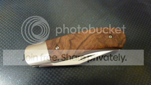

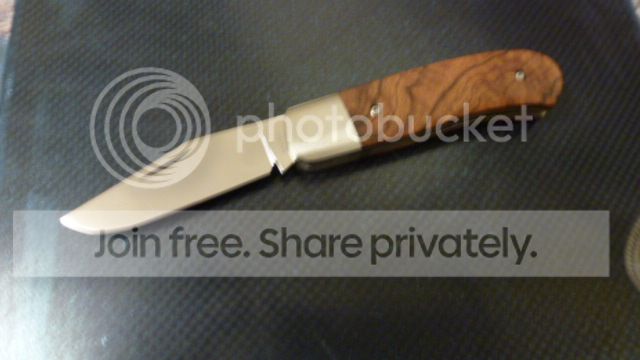

Hi Obi Wan Javand (my slipjoint Teacher!!), what do you think is the best preparation for soldering? I mean finish grit (i use 500 g) and cleaning (i use pure alchool).
Up today i used the pre-tinning way, with good results in terms of invisibility. Pre-tinning i can recover the edges, which tend to scorch a bit, so i can reflux and scrub with a SS rod until i get perfect tinned surfaces. The thin pieces of wire, flux and clamp won't allow me to scrub any scorched area may happens, so i'm afraid i could end with some black line/dot around the joint.
I am very tempted to try the method, since pre-tinning is a 6 steps soldering operation for 1 knife, while the other method it's just 2 soldering steps!!!
