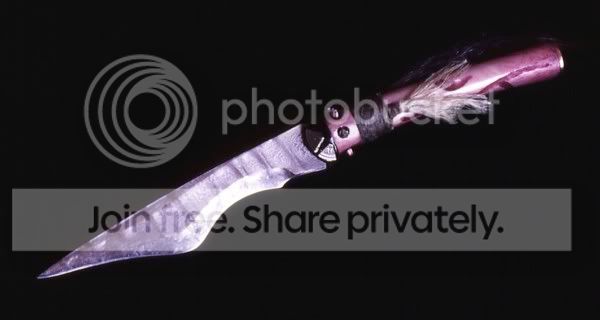

Here’s a piece I did a good while back, bug cleaned and air dried lamb bone, died with wild, natural, hand picked cochineal die. The blade is meteoritic hand forged air hardening pattern welded steel. Inlays of rat's teeth and cleaved coinage. The inlays are done with natural pinon pine rosin mixed with Alaskan moose dung ,…cutler’s rosin. The wrappings are homemade AZ “century plant” fiber cordage with cochineal die.
You don’t get that look, feel and HADO any other way! :)
All three planes on the blade "flats", or audience sides, are hand forged hollow...
