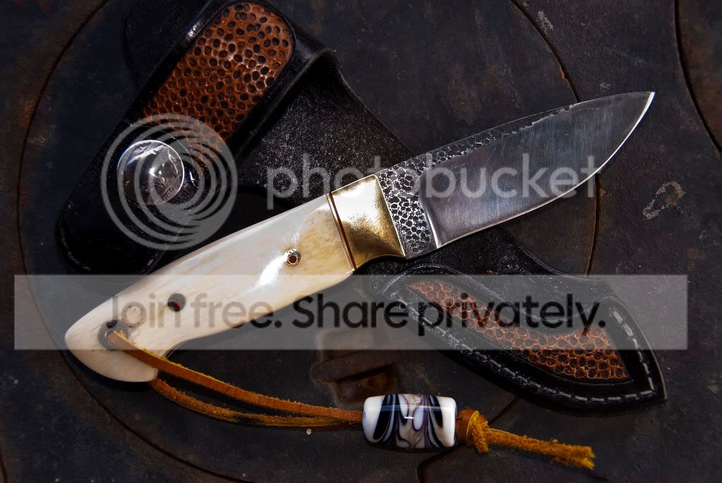

I have a bone handled knife and only super glued the bone and polished it keeping the buffer loaded with white rouge. Have not had the speckling problem some have noted. here is a picture.
http://i289.photobucket.com/albums/ll236/MT-Borg/9knife2.jpg
better linkie?
