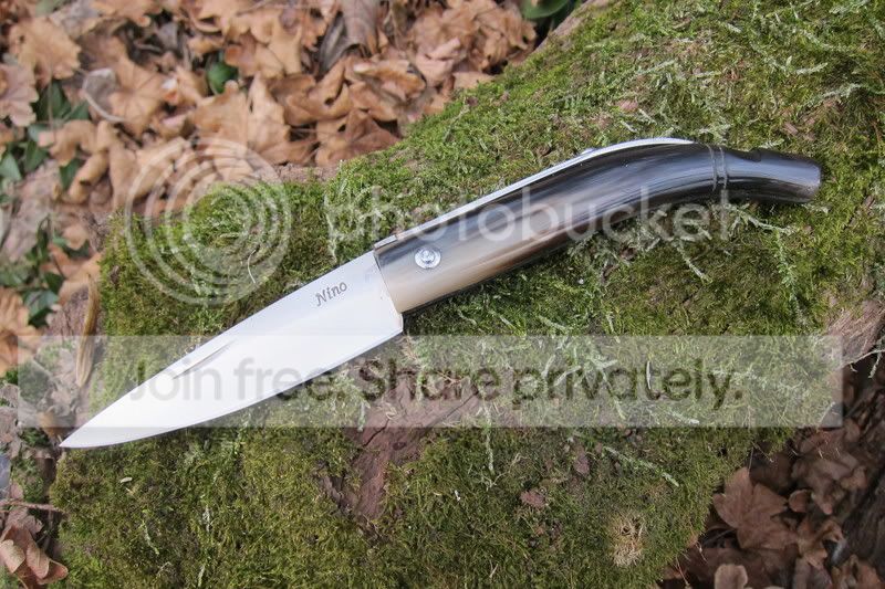

Has anyone seen or especially personally used bone or horn with or without liners for a shadow pattern folder?

Bone will be easy to crack at the pivot pin, and horn warps and shrinks.
Soldering stainless bolsters isn't hard. Use Stay Brite "silver" solder and Stayclean flux. Rough up the areas to be soldered, immediately apply flux and heat until the solder melts.
I've made many shadow patterns out of bone no problem, but I usually use a reinforcement
thick birdseye type of washer system at the pivot. Done right you shoudn't be able to see
the birdseye effect when its peened. I make a thick washer out of rod on a small lathe.

Well here is one just to show you it is possible to do what you want. Use a washer and pein just like a straight razor, I know you know how to do that.
Not mine, borrowed pic.

I do know how to do that! I came to bladeforums from a straight razor forum after completing my first complete ground up build and restoring several others. It might be interesting to try one with a peened washer. Hmmmm.......it's not traditional but who cares?
