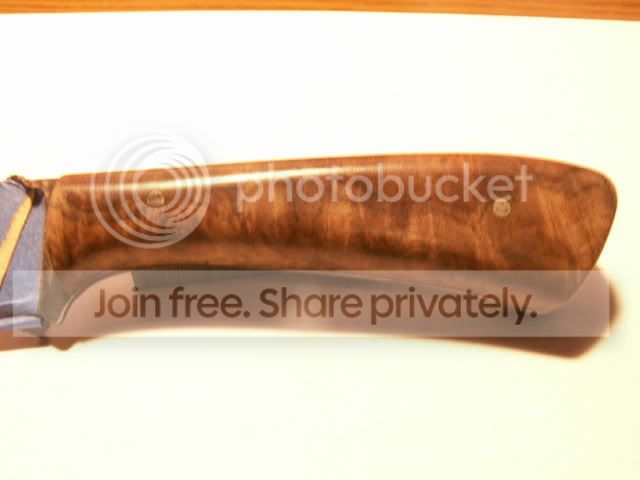

Okay, it's the first time I was using mosaic pins, on a fillet with a pair of SWEET walnut burl scales. I glue up everything, and head over to the arbor press. do I look to make sure they are lined up? HELL NO!! so I used 5min epoxy and it is now 4 hours later. What can I do to knock out said offending pins and put in a fresh pair - without tearing up the scales?? I am kinda scared to put the heat gun to em since the walnut is full of acryloid B72. That wood is so sweet the pic does it no justice.

Most often they will come easier than you might think. Most often. Just protect the wood, and drive them out with a hammer and punch.
try using the tip of a soldering iron, epoxy loses its streangth when it is heated to high, just be careful not to scorch your wood
If the core metal is not stainless you can drill them out. Once they get hot during the drilling they often slide out on their own.

Stick it in an oven (toaster-style) at around 200 F. When it gets to heat, "CAREFULLY" drive out the pins with a punch.
Just remember that mosaic pins have epoxy in them, so if you drive from the center, you will simply drive out the inner design and leave the thong hole tubing.
Take a square-ended small punch and "CAREFULLY" drive out the outer tubing from the edge of the tubing. It helps when you have somebody to hold the hot blade while you drive the tubing out.

Well, I have instruction, but boy am I SCARED! I am sure you guys know what its like to look for the perfect piece of wood for months and find it. Enough of the tiny dude playin the sappy violin music, time to get it fixed. Ugh. I am gonna try the localized heat method, still fearing acryloid B72 meltdown.
John, the problem is that they are turned different directions. Any amount of other pins won't make these straight. But your suggestion is often a valid solution.

Well Chris, neither of em are lined up in any way to the line of the handle. Meaning either one of the three are @ 6 o clock, or two of em are not parallel to the centerline for the handle at the bottom. I wish it was only one cause like you said I would only have to knock one.
After heating it up. is the epoxy ruined? If yes the what about the handle epoxy. If no seems to me that you could take the exact same size pin use that to press the pins out alittle spin them to correction position. Then press them flush, let'em cool down
I say try lightly tapping with a punch of the correct size first. If you haven't scored the pins on the middle,or peened them a little, they may just drive right out. especially if they heated up much during handle shaping.

Drive the center of the pins out leaving the tube. Then put he innards back in (the correct clocking so it looks good) while filling with clear epoxy maybe?

Well, I got em out. used the soldering iron method and a dremel 1/8 shaft and the arbor press. The wood ON TOP pulled away from the blade??:confused: But anyhow, the holes got enlarged a hair. No biggie, I should be able to peen the ends a hair. I am confused as to why the top piece pulled although teh press was pushing, and the stuff was flat, already glued before I pushed the pins to begin with. Oh well, time to press on. Chalk this up to another episode of "Learning the Hard Way", starring little Timmy the oblivious soul to paying attention!!:D Stay tuned for V 3.0, coming hopefully later than sooner!! thanks for all the help guys.
