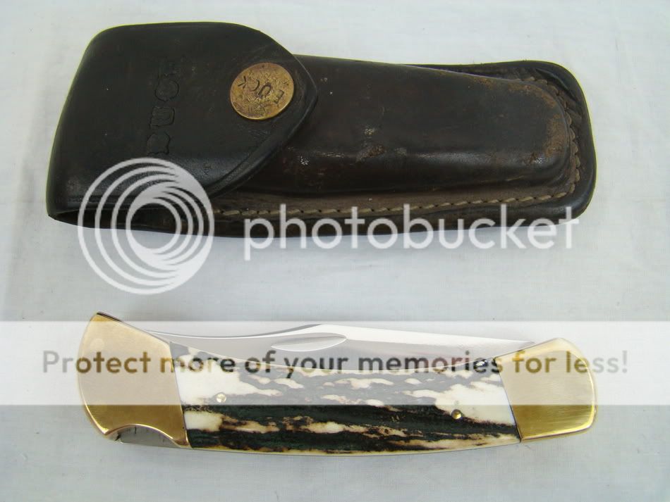

Hey thanks it is a nice knife. I get all weak in the knees with early 4 dot, pinned stag with really well matched scale. Heres the link to the auction and it has a Image Logik banner imbedded with lots of good pictures that you can zoom. The knife looks unused with a mirror blade so I don't think that's the original sheath. Could be wrong about that. Anyway, check it out if you like.

I love that fossil ivory.
yes some one else wanted it badly also..wander who?
i timed it almost to close or he got slow on the typing..
it was a stretch to get it ..
now i am in money dog house again..:eek::(
gee i hate the taste of brass and wood..
as it is eat buck knife time again..:o:rolleyes:

Beautiful knife. Nothing like a nice chunk of stag on a Buck.
