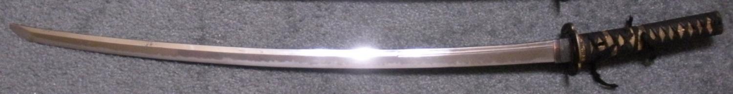

I already posted this over on the nihonto message board, but figured it wouldn't hurt to show it off here as well, and maybe see if anyone else could venture a guess as to its age, etc.

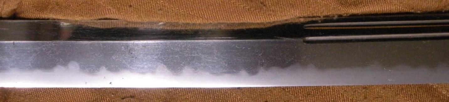

I bought this sword at the estate auction of a WWII veteran. It has 2 narrow fullers on the front, and one wide one on the back. The blade is a little over 27" long, and it's gracefully light- almost petite.

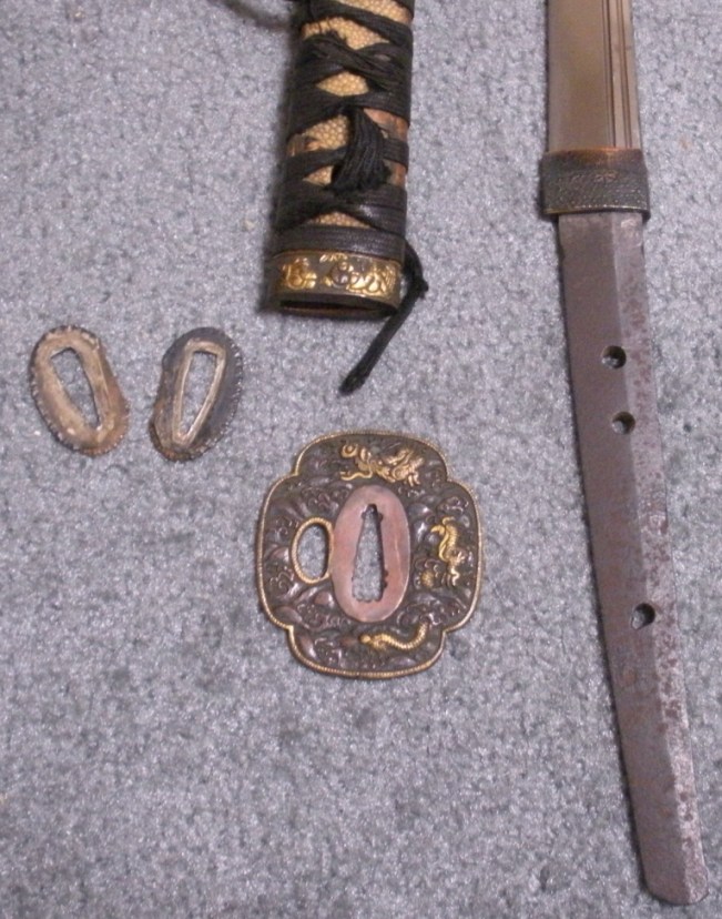

It has some nice fittings; I really like the tsuba. It's copper, with a gilded dragon weaving in and out through waves.
The only marking I can find is "ichi", but given its location the other guys are certain it was added later.

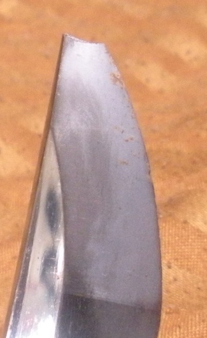

Unfortunately, someone broke off the tip of the kissaki, but the other guys think a good polisher might be able to save it.

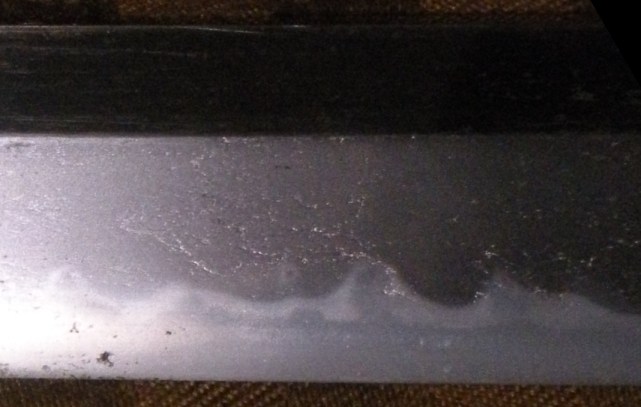

When I first picked it up, the grain in the steel and active hamon really caught my eye.

I read your post on NMB, and agree with what they said in that the kissaki most likely can be fixed by a trained polisher and the "ichi" character was probably added later.
One thing which I didn't see addressed related to it being signed "ichi" as in Ichimonji, is that the shinsa team may reject it as "gimei" or false signature if they deem it not ichimonji work. Therefore you would not receive papers after paying a fee for submission to the shinsa. I can't remember about this particular group of the NTHK, but the NPO branch is good about giving information regarding their thoughts on who the maker may be, though you still would not receive papers until the mei was removed and the sword resubmitted.

I think the old habaki would still work, since the base of the blade is in pretty good shape, and the tang is thicker about an inch back from the machi anyway. In other words, if you made a habaki to fit the blade tighter, you wouldn't be able to slip it up over the thickest part of the tang. It probably needs a shirasaya anyway, since the tsuka core is completely broken, and it does not have a saya to start with. It came stuck in an old gunto scabbard which does not fit properly, and damaged the mouth of the habaki a bit.

Without looking at it in hand, I feel that it can be restored. Yet, keep in mind this is from a few less than optimal photos.There is no reason why you can’t do it in stages. There will be another shinsa in Tampa 2/2016
It does look as thought he old habaki would work, it just looks nice when you have a new habaki with new polish and shirasaya. The thickness of the nakago is irrelevant, a new one can be made and will fit. They should not touch the sides, only the top and bottom of the nakago come in contact with the habaki, which is why it works.

I personally do not recommend or condone using a less than fully trained polisher for an antique blade. The sword in question needs the kissaki reshaped, and I surely would not trust an amateur for this. I can only imagine the disappointment of choosing this option.
