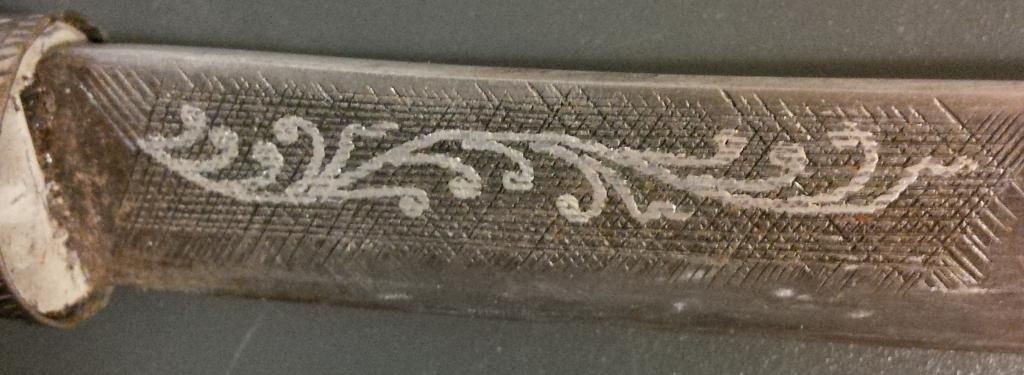

The crosshatching is actually something called Koftgari. They heat the blade up with a torch and then cut the crosshatching with a hard knife or chisel. Then they take some silver or copper or gold wire and press it into the crosshatching to make the pattern you see. Since the steel is still hot, it sticks to the grooves. Then they burnish the whole thing with a stone. Because the silver is rubbed into the notches, it won't wear off easily. Normally they're much more artfully executed than on my dha. You can see a video of the process here.

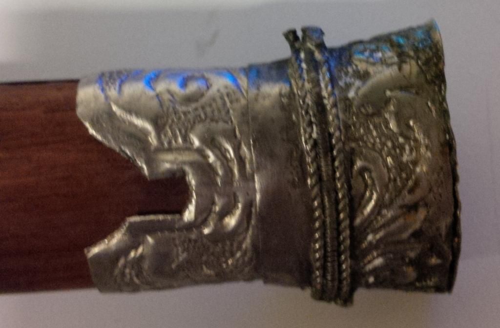

To call the workmanship of this knife "crude" would be a generous understatement. Everything's hand made, though. Here's a close up of the rope pattern on the sheath. It looks like they soldered an actual wire to the sheath, you can see at the top where they twisted the ends and snipped it off. I think you'd call the pattern work on the metal bands Repousse. They basically hammer a pattern out on the back of the metal sheet, which makes it bulge out, then they take a nail to the front of the sheet to add detail. Again, it's usually done much nicer than this.

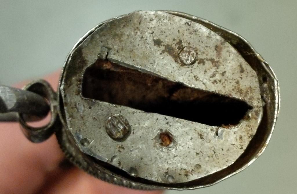

I especially like how the master craftsman attached the throat of the sheath with a couple of nails.
