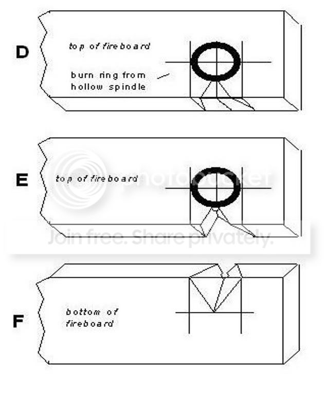

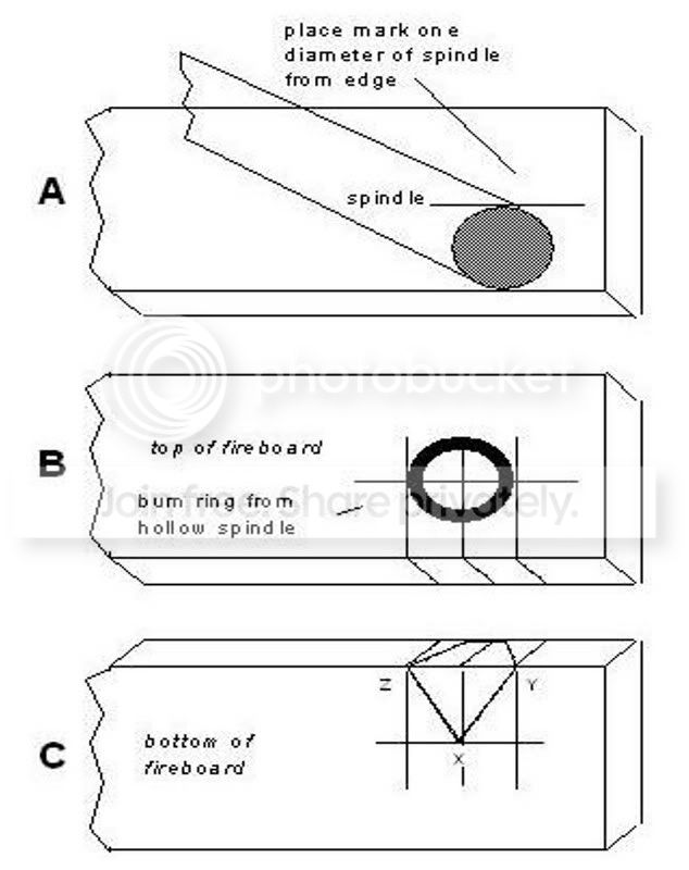

One thing I noticed from your picture is that your depression in the hearth is awful close to the edge of the board. Of course, I know this was only for practice. If you make the depression too close to the edge you can sometimes experience a problem with the drill popping out of the depression, laterally.
Another thing, I don't know if you had any problem with string slippage, but if you did, you will find by reverse cording your string it will afford better traction with the drill.

One thing I that has worked for me..
I don't place the hole in my board quite so close to the edge. I have had better luck spacing it away from the edge. I have incleded some diagrams to so what I mean.
Like I said, this is what works for me.. Looks like you are doin fine, keep practicing, and figure out what works for you!
Mike, great graphics!!!!! That is super-helpful. Thanks! :thumbup:
One diameter away from edge, that is also a very easy way to remember it! :thumbup:

OK guys, why is the Vee notch so important?
Why couldn't someone just turn the hearth over, and dump the ember into the tinder bundle??
What does the notch do?
Unless your spindle is hollow, without the v notch there is no place for the coal to form, it provides a place for the char powder to gather and eventually combust. Chris
