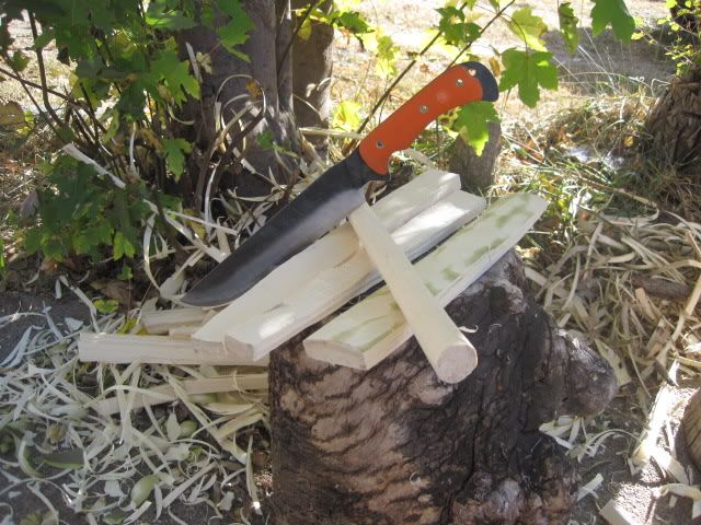

In the next couple of picks you can see that I got some sycamore wood 5" thick and about 5 feet of it. I got this just a couple of days back in my neck of the woods. A storm and nocked over that small tree a couple of weeks back and I am not letting it go with out getting me some prize straight grain sycamore wood for spindles and hearth boards.
Today I cut off a portion of that log and then split it with my knife and carved up a few hearth boards and one fat spindle this afternoon.

PS. KEmSAT Survival if you read this take a look at that knife with orange handle. I did change the pommel some as I did not like the angles that you designed on your knife design. other than that I keep it pretty close I think. Great design. I hope to use the divit in the handle wednesday. for the bow drill.

Bryan, tell me something, why are most handle designs with a bow drill divot, placing it so close to the end of the handle? If I were making it, I would put it in the centre and use 4 pins instead of 3. I think it would be much more comfortable to use.
Doc
DOC, this is the first time I have ever done that to a knife handle. I did mine here instead of in the middle to try out since there is a longer blade and more wieght towards it I thought it might balance it out a bit more. The design that I was sent for this knife design does the the divit in the middle but after i handled the knife when I got the handles on it I had a thought to move it over some. If it does not work I can change out the handle and redrill if I want. If you want to know how it works just let me know and I will tell ya.

I think maybe the intent behind that is to put the divot in a place less like to effect the stronger fingers in the hand that do the most gripping in the handle. Maybe to keep from causing hot spots in the tips of the fingers applying the most force in a grip in long term use. However having knives with divots near the pommel end and ones with it in the center I find all of them serviceable but the ones with the divot in the center more comfortable for a bearing. Personally if I ever do one of my own handles that way on a longer bladed knife I am going to try the divot closer to the blade end of the handle so the weight balances better and I can then just apply the pressure with the heel of my palm.
That's cool, Bryan. Looks like it works, judging from that mountain of shavings! Like I said on the phone, you're free to have fun with it and change the original however you need to. I hope it works well and performs like I had hoped when I conceptualized it.
