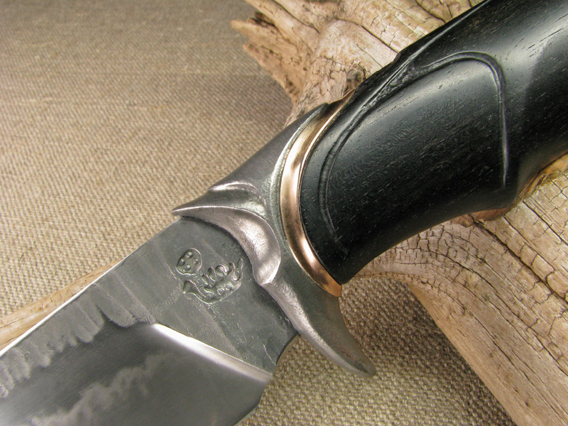

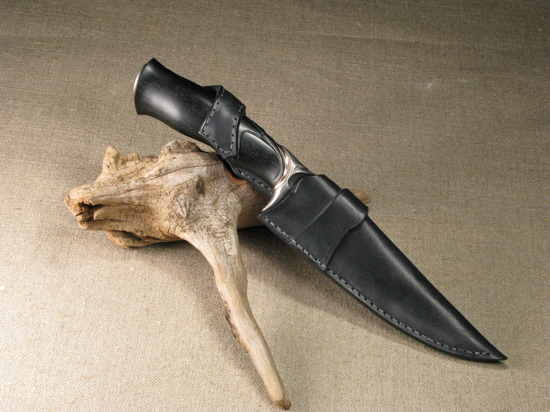

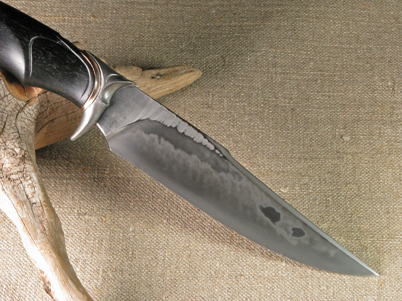

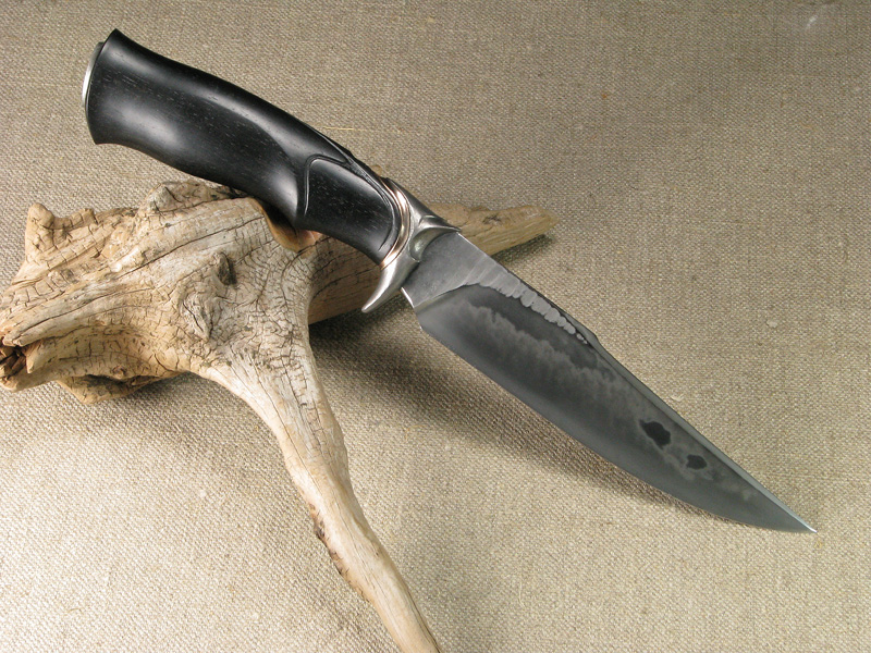

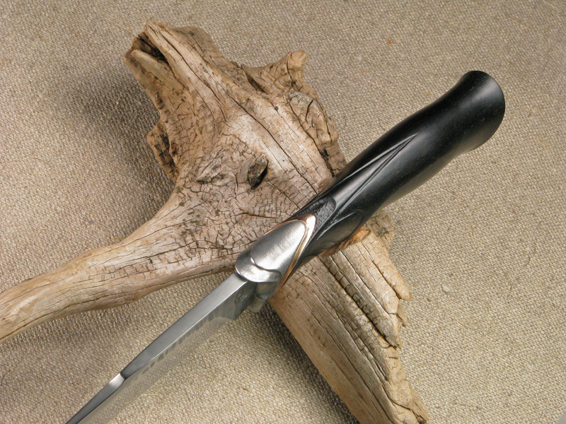

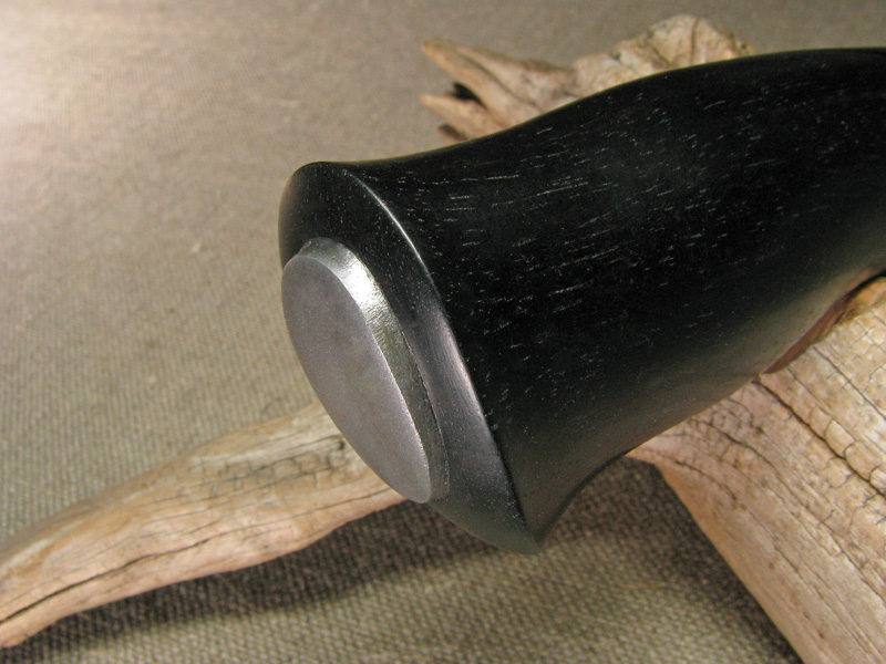

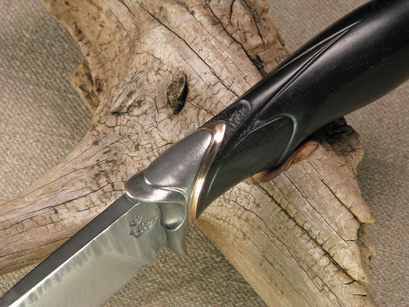

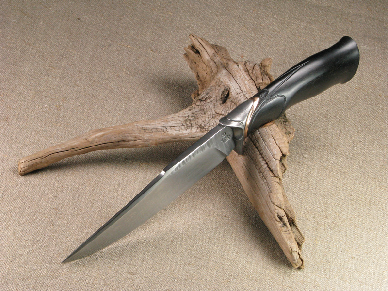

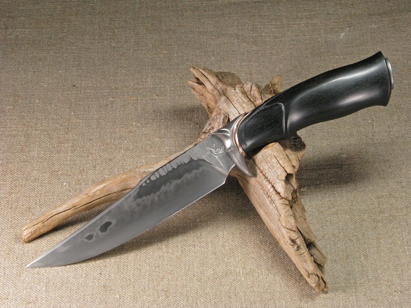

hi all,
one of my best customers ordered a new bowie (design: free)
he is a friend of fantasy-literature and owns amongst others this one:
http://www.messerforum.net/showthread.php?91089-BLACK-DRAGON
so I decided to try it in a matching style.
the special hamon created the name `DROGONS EYES`.
some specs:
W1 forged
guard: steel/bronze
ebony
leathersheath
length:30cm
16cm blade
thickness: 6,0-2,0mm
and now have fun,
and thanks for looking!
gerhard
I love it :thumbup: Sculptural, polished and rough hewn all in one. Great blend of materials and a very elegant/lethal shape.
Sheath too is very nice. Great work.
Gerhard - I echo all the previous compliments. You have such a distinctive style. If its possible, I'd love to see more photos of that sheath.
Peter
That is one of the best looking fixed blades I've seen....love everything about it

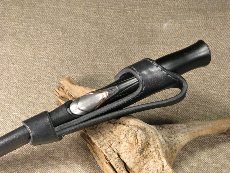

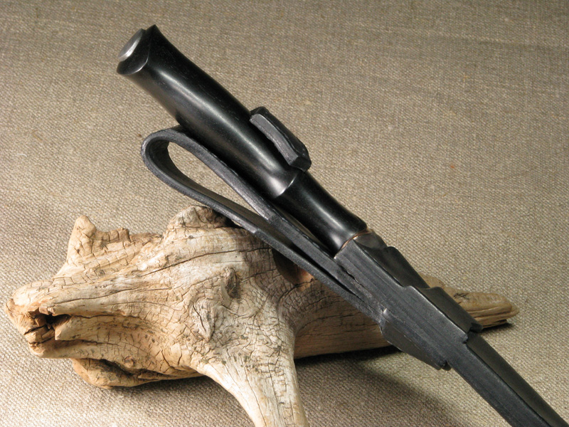

thank you all for your kind posts, I´m glad you like this bowie!
@p.mckinley,
peter, this is the only additional foto of the sheath:
the safety-loop has springwires between two sheeths of leather.
gerhard
