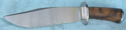

Bowie in Ironwood, My new favorite handle material!
Jun 10, 2001
1,385
This is my first time using it and wow it finishes nice.
This link has a couple more pics.
http://www.bladeforums.com/forums/showthread.php?s=&threadid=190862
Made from 1/4" 5160, double quenched, cryo'd, Satin finish with a visible temper line,
416 fittings Ironwood burl Handle. Blade is 7 3/4" tip to guard 13" OAL. Ironwood
balanced this blade out and it feels light

Robert, Thats a good looking Bowie.
I too love ironwood, in fact I complain when someone wants another wood on thier knife.
I'm partial to maple burl or amboynia burl myself but now I have to get some of that ironwood myself. Great looking knife Robert.
Thats an awsome knife, the iron wood realy goes well with the overall desighn.
How did you finish the iron wood? I've not used a lot of woods, and I understand that you can't stablize ironwood?
Will,
Sand to a 1200 grit, buff lightly W/ Green Chrome, Finish - Very lightly with Scratchless Pink on a loose Buff. Butter smooth;)
It is an oily wood so it won't stabilize, doesn't need it.
Thanks Robert, how well does it hold up for a user, dosn't most natural woods turn black over time and use? I guess that is one fear that is stoping me from useing more wood.

Robert, that's a nice piece of ironwood with a great new home. And one fantastic flat grind..

That knife is a good looker very nice job, Ironwood
is almost as indistructable as Marcarta it is one of
the best, just make sure that you use a mask, you
won't forget after the first whif fo grinding dust.
Gib
Looks like a helluva whacker there bubba! How'd you do the guard? It looks like two pieces of nickel-silver with a spacer?
