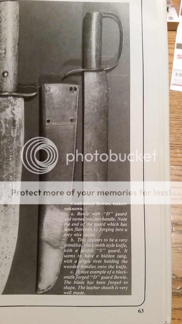

Here's an example from the book "Bowie Knives and Bayonets of the Ben Palmer Collection". Captions on pics by Bill Moran.

If I had to guess I would say that "Brute de Forge" style knives from that time period were considered low end or low cost knives. I would also guess it wasn't done in a stylistic way as we do today it was probably a way to skip the finish by hand with stones phase. If my assumption is right then I imagine that is why we don't see them in books or museums, who wants to see a low end knife. I would liken it to having cheap chinese made cutlery in a museum 500 years from now. This does make me want to know when smiths started making knives and intentionally leaving forge scale on the blade for aesthetic purposes. Anyone know?
Keep in mind this is all conjecture on my part.
As a side note when I took the two week ABS class last year I worked with 3 or 4 ABS instructors and all of them referred to a brute de forge knife as a knife with some forge scale and a flared guard on the finger choil made popular by Joe Keesler.
-Clint

Just a note, Brut de Forge means "as forged finish" in French (no E on the end of Brut) or more literally "roughness of the forge"
By the way, great find on that old bowie, Tad!
