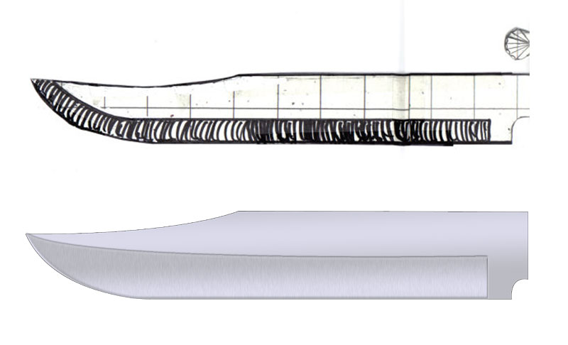

I need your opinion on this! I want to build a Bowie with a blade having these approx. demnsions:
blade to be made from 1/4" thick steel
11" length blade
1 5/8" width
The reason I ask about this is I am trying to draw a, to scale drawing and the curve of the blade and the clip point does not look right. Something about it, is not proportionate! I really want to get this problem solved so I don't end wasting a piece of steel!
I do not want to change the length!
Is the problem the 1 5/8" width of the blade, should the blade be wider for the 11" length?
Or is the problem the blade curve and/or the clip point?
Anybody got any suggestions, on the question of proportion problem with this blade? I think I know the problem but I don't want to influence any one else's opinion.
1'' scale drawing scanned for this pic attached:
Note* my scanner does not do a perfect 1" square when I scan, it will be slightly smaller.
This is kind of pre-build critique on design!

That is exactly what I suppected was the width was too narrow, because no matter how I played around with the blade curve and clip I couldn't get it to look right.

I do my drawings in Photoshop. It is fairly expensive and has a steep learning curve but I find it invaluable for doing "what if" designs and then rendering a good picture to show a customer. I also use it to printout full sized blade templates that can be traced onto bar stock.
One of the neat things is that you can work in layers. The blade, handle, guard, etc. can be drawn in separate layers and shown or redeigned individually.

A knife with a blade length of 11 inchs, sets the overall length at sixteen or sixteen and a half inches, which is a lot of knife in anyones book. As mentioned above I also believe the blade is to narrow for the length, just under 2" seems about right. If you add that much width to the blade, it will change the overall look a great deal.
An 1/8 of an inch is a lot on a knife.
Quarter inch material, at 11 inches is not overly thick. You don't have much to play with. This is a forgers viewpoint of course.
To me; A knife of that length looks odd when it is straight, they need curvature along the handle and spine. Unless it is a stabbing weapon like a dagger or rapier tanto and the like.
If its only meant to pierce, make it straight; if its both a chopping knife as well as a stabbing weapon, the point and nose of the knife needs to be below the hand that's holding it.
Go on Donn Foggs site and look at the bowies and fighters there. One theme you will notice overall, is most big knives don't have many straight lines to them.

1 5/8 is not too narrow. I you are asking, I would suggest going with a flat grind and maybe shortening or shallowing the clip a bit. Also, a good rule of thumb is to line the point of the knife up with the center of the handle at the guard. If you want to raise it or lower it a tad, then go ahead, but start with it centered and see how it looks.

FYI, the knife in the center of the photo of these Randalls is 11" x 1-7/8" x 1/4". Looks pretty good to me.
