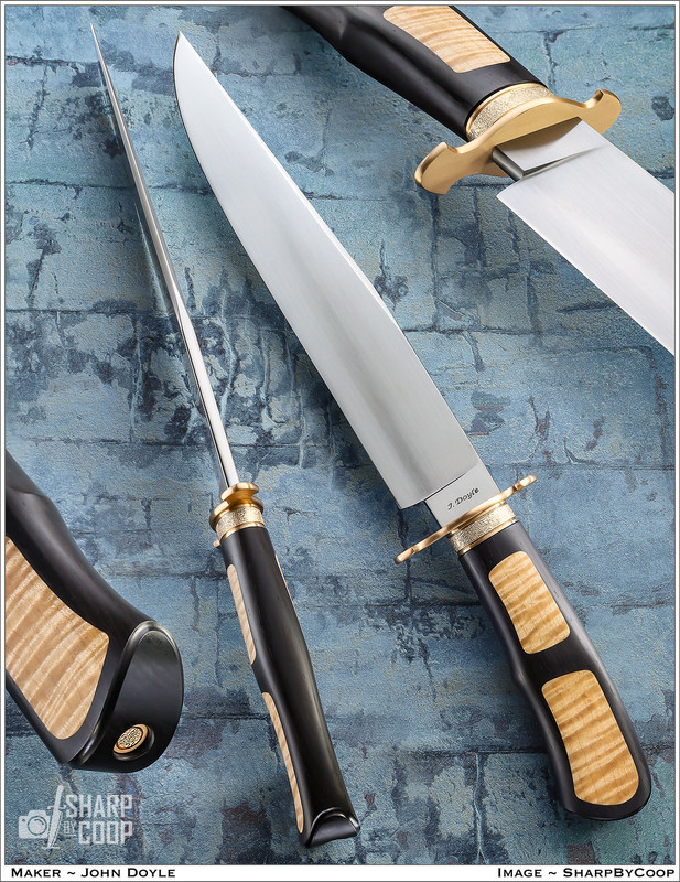

I just got this pic of my latest bowie.
The blade is forged from w2 steel and has a neat "no- clay" or auto- hamon. The blade is 8 1/4" long and overall length is 13 1/8". The guard is sculpted from bronze and has rounded edges. The spacer is also bronze and features a stippled center band. The handle is African blackwood with two separate solid stabilized curly maple inlays. The butt end of the knife features my signature carved flute and there is a decorative finial bolt cap made of bronze with stippled center to match the fittings.
Thank you for the outstanding pic Jim!
