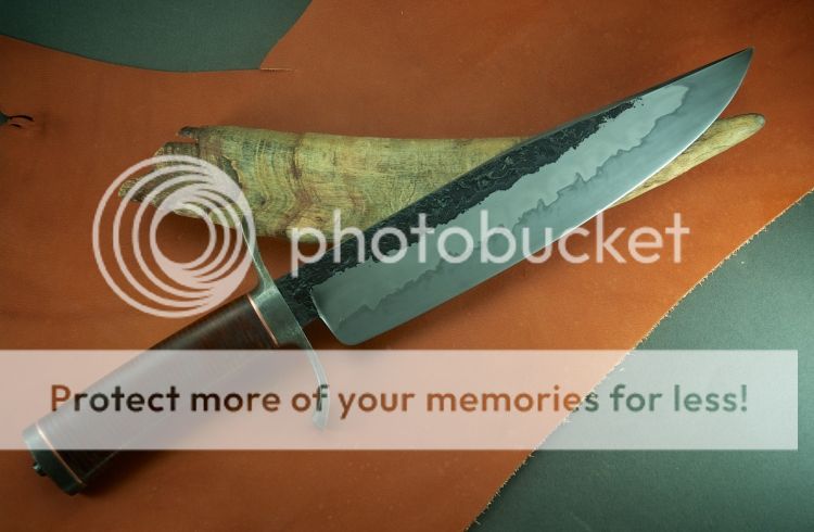

I went with the dark hamon finish due to the "rustic" nature of the piece. The fittings are deep etched wrought iron. W2 as usual for the blade, copper accents.
It's a big knife at 10 1/4" for the blade and 5 1/8" for the handle and 9/32" thick at the ricasso.

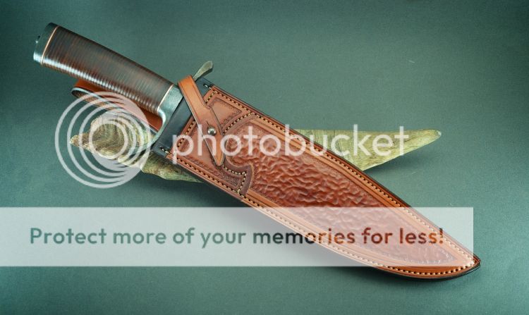

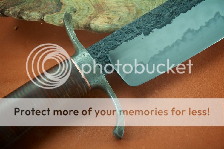

I like the big sweeping guard on this, something usual for me. Not to mention the stacked leather. On that I didn't go to the full polished finish as I liked how grippy, warm and organic it feels like this. I didn't want to seal it in epoxy or anything but it has been heavily treated with leather balm, gum tragacanth and tung oil sealer, burnished and buffed...

Stuart, did you take any picture before "darkening" the hamon? I see very interesting things above the line!! Packman ghosts pattern? ;)
This one is totally the kind of stuff I dig. You don't see much stacked leather anymore which is a shame. It's so handsome. The shape and proportions of the knife are just perfect. The sweep of the guard is beautiful. The design of the sheath is fantastic as well. I love this one!

Stuart... I really dig this knife. The handle and fittings are top notch, with a wonderful classic feel. Visually, the package works really well together. If I could see one thing changed, I'd like it if the ricasso were widened slightly toward the front, so it lined up with the front of the handle. It think that would visually tie the profile together and give the piece less of a blade-heavy feel.

When making a hamon, the thickness of the blade has as much or more of an effect on the hamon as does the clay. The "ghosting" shows more of the clay and the actual line is the result of the "thermal mass" of the blade at the quench. I am always trying to play with that relationship and the other factors.
There's lots of the "utsuri" activity above the line and a lot of subtle details that could only have come from the full polish but that didn't really suit the rest of the knife.
For those that like this hamon, I have another knife that I made with a similar clay layout but there is much less steel mass above the line to affect the hamon and it is a crazy looking thing.. I can't wait to polish that knife.
Erin, yes you've found the one thing that bothered me a little too. It's much better than it was at first as Lorien could attest to. Still the ricasso is over 1" wide..

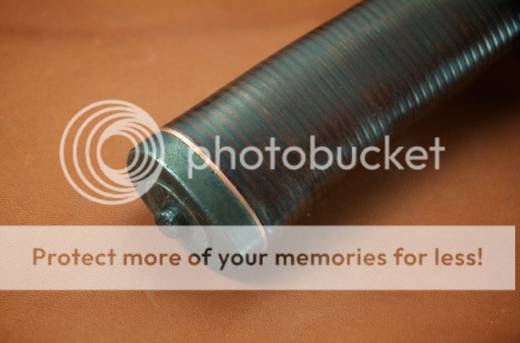

Thanks. The toughest part of the stacked leather handle is that I made it for a dropped handle. Most leather stacked handles are straight. This one drops so I had to glue up the stack with a radius. It might be hard to see but you'll notice that the lines of the individual leather washers are not parallel but radial.. That way there's no wedge shaped piece where it mates with the butt cap.
So did you use a computer program to work out the edge angles on the washers to get them that perfect? :D
