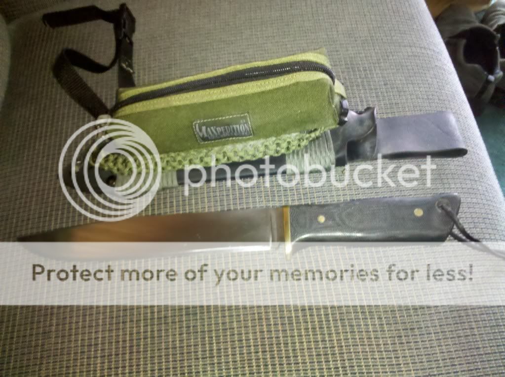

Here is a pic of my rehandled Trailmaster in G-10 along side its homemade kydex sheath...
