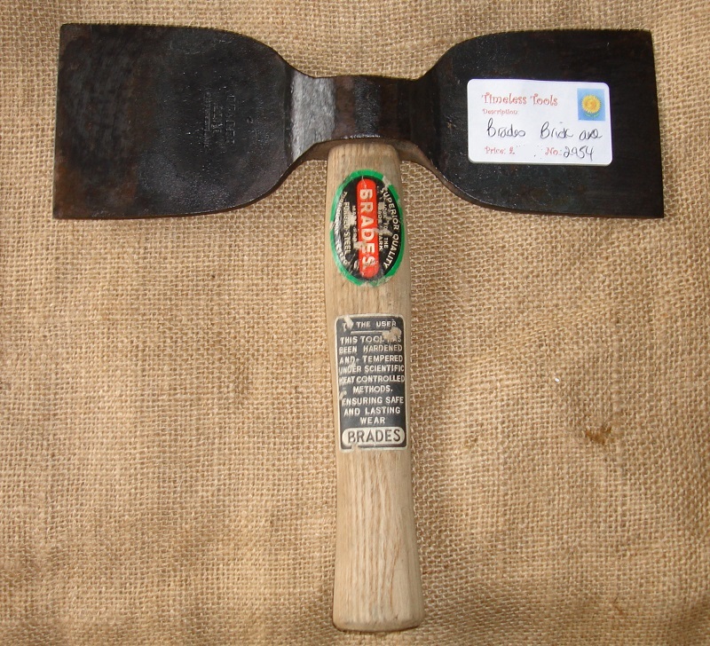

I have a Bow tie hatchet that was given to me in a box of rusty tools. I guessed it was home made , until I hit it with a wire brush yesterday. It's lightly stamped WPA - which didn't change my mind about it being a one of a kind craftsman made.
I was surprised to see it had a manufacturers stamp on the other side Anyone familiar with "Handmade" brand tools?

Far out Square_Peg! But what on earth would Works Progress Admin. have to do with tomahawk-type implements? Roofers, plasterers, form setters, fencers, farmers, and trappers etc. all seek hammer faces to go with their blades. The plot thickens.
Thank you Steve. Now it makes much more sense. Although I wonder whose political affiliation the company owner was that managed to find a gov't-supported market for these. Useless tool otherwise since masonry/brick hammers had already been around for a long time.
Steve,i've an identical small side-axe to your last couple photos.I used as prescribed,as a carpenter's hatchet.(Most satisfactory tool,we've been happy together many years).
As a smith,i can clearly discern some individual hammer-blows that helped shape that tool,and it has most definitely been forged "by hand".
Among the US,British,and Canadian smiths,this subject has come up regularly-what constitutes "Hand"-forged,-made,et c.
The informal consensus seems to be that to qualify as such the forging must have been Held by a living hand while forged.
