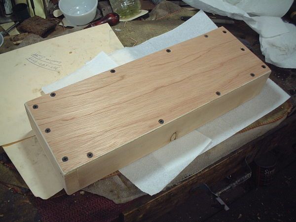

I've been making wooden boxes for shipping for a full decade.
Check the thread here and see that the Priority shipping cost is only $9.95. What do you pay for shipping in your box?
When I ship this way, I always feel at ease that the knife is protected.
Consider that a sheet of luan only costs about 12 bucks. Think how many boxes can be made out of a 4 X 8 sheet!
I rip 1x10s into strips.
At first thought, people think they're heavy and expensive.
Wrong on both accounts.
I rip my sheet into strips right when I get it home and stack it up and out of the way.
All the boxes are the same width.
They only vary in length.
Inside, my knives are in zippered pouches.
I won't ship a knife any other way, and my method has long since become 'legend' with my customers. :)

Karl that's what I had in mind as well, only I was thinking staples instead of screws, but it seems worthwhile, especially when you get into more expensive knife territory.

My very first shipment of steel into Hawaii came from Karl about five years ago. He sent me 67 pound in one of those wooden boxes slipped into a flat rate priority mail box. Pretty good for $9.95 in postage...and not a morsel of steel escaped!
