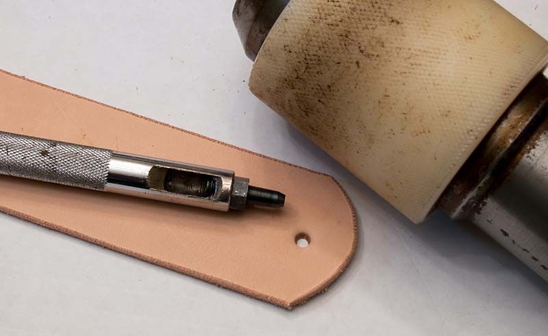

putting snaps in you will need to make holes for them to fit through
adapter_4.jpg~original
