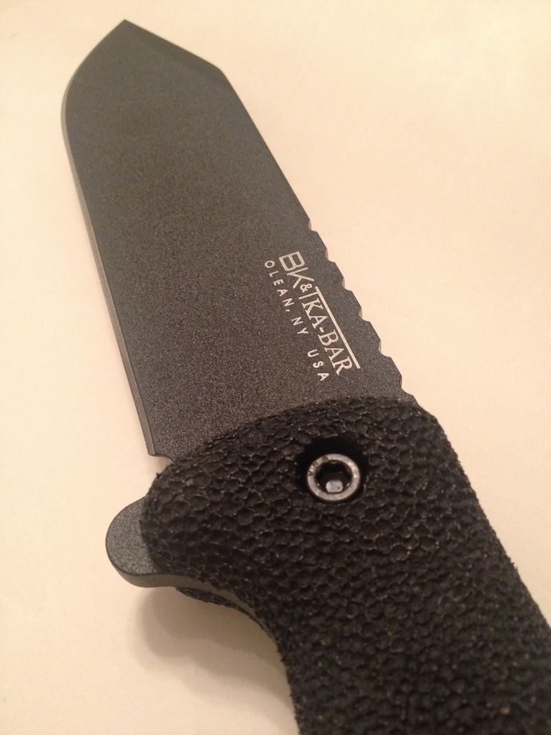

My name is Barry and I'm new to this site and also to the Becker line of knives. I bought the bk10 because I wanted a reasonable priced, good camping and hiking knife that I could beat on. I got the knife last week and was very excited when I opened the box. After fondling it for a few hours, I couldn't get over the thumb ramp and the smooth handle. So I watched a few youtube videos, read a bunch of post here and dove in. After I stippled the handles and removed the thumb ramp, I decided that I also wanted to add jimping. I'm pretty happy with the results, being that it's my first time modding a knife. All that's left is to get it broken in.

I mostly used the dremel to do the jimping. First I started off with the cutoff disc and tried to get it as close to the finished depth as possible. Then I used a tungsten cutter to remove most of the metal and get the circular shape. Finally I used the chain saw sharpening stone which was the perfect size 5/32 and it also helped to smooth everything out. I tried using a rat tail file at one point but it didn't workout that well.

Nice job man! Get bitten by the Becker Bug! Jimping looks great, must be the TravisH method?

For the stippling, I used the corner of a flat tip on my soldering pen. I've stippled a few paintball markers before and I found that regular pointed tip would make the pattern to symmetrical. I personally like a more random pattern so I change the angle as I go.
Sorry for the poor pics. It's 4:30a and the suns not up yet. lol
