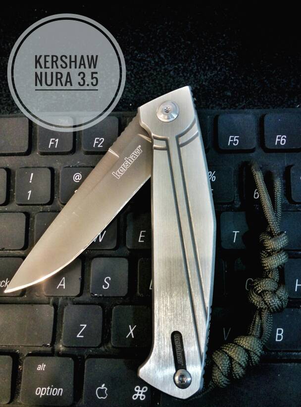

I just received an order from a knife company yesterday (I'll leave their name out to avoid any potential issues or marketing), and 1 of the 3 knives was a Kershaw Nura 3.5". It was the only box of the 3 that was crushed during shipping, and upon opening the box, there were some markings and discoloration on the handle around the pivot, and what appears to be a light layer of dirt/dust inside of the knife. The worst of all, in the open or closed position it makes a clicking sound when the knife is moved around. To the point that I feel like even if it was in my pocket and just simply walking would make it make the clicking sound. I almost think that one of the ball bearings in the pivot is too small or broken or something and clanging around inside, but I don't know. Is this sound normal on brand new cheaper IKBS pivots? Or should I attempt a refund? Almost seems like it was a return from someone else considering the markings and debris on the inside.

Can you isolate where the clicking is coming from? Is it around the pivot area? Sometimes a pocket click will make the sound, but that is usually very easy to distinguish and fix. Or something loose around the pivot area? Try and figure out exactly where, if possible.
It's around the pivot area I believe, it's definitely not the pocket clip since small movements make the rattling/clicking sound. I'm half tempted to open it up and see if I can fix it myself, but then I definitely wouldn't be able to return it

Could be just the torsion bar.
Happened to one of my ZTs. All it needed was some grease.
Bingo, I think Jens Schuetz nailed it. I've had "rattling" torsion bars before. One was even on a ZT...

Yup. No torsion bar. That would normally be the issue but not if there is no torsion bar. OP, if the package was damaged the company should take the knife back paying shipping and not charging a fee. Any decent company will do this as until the purchase gets to you safely the knife is theirs. It didn't get to you safely. That is on them. I know you said you didn't want to name the company but knowing who it is could help in advising you in this situation.
I figured out where the noise is coming from, the standoff in the middle of the knife, it serves zero purpose since it's not screwed in at all, it's just....sat in there. Very poor design choice, I'm debating super gluing one side down to the lockbar scale so it stops rattling, and I'll still be able to take the knife apart.

This is my Nura, it works fine, the blade is perfectly centered, very smooth to open and close.. You can disassemble the knife, is very simple, just 2 torx screws and inside you will find only the blade and the ball bearing, check them and see if you resolve the noise problem..

Thanks guys, I really appreciate all of the responses. Based on all of the feedback I decided to take the knife apart after learning that it was the standoff in the middle of the knife making noise, and super glue said standoff to the lockbar side scale.
I deduced that this could potentially be a problem with any and all Nura's since it takes extremely tight tolerances to make a loose component tight and flush, the kind of tolerances that you'd need for a $200+ knife, not a $25 knife. It also seems that centering and smoothness have been issues for some Nura owners, again due to tolerances, and I happen to have a very smooth and perfectly centered copy. Based on that, I figured it was best to suck it up and fix the problems with mine instead of attempting to return it and possibly having new and worse problems, rinse and repeat.
