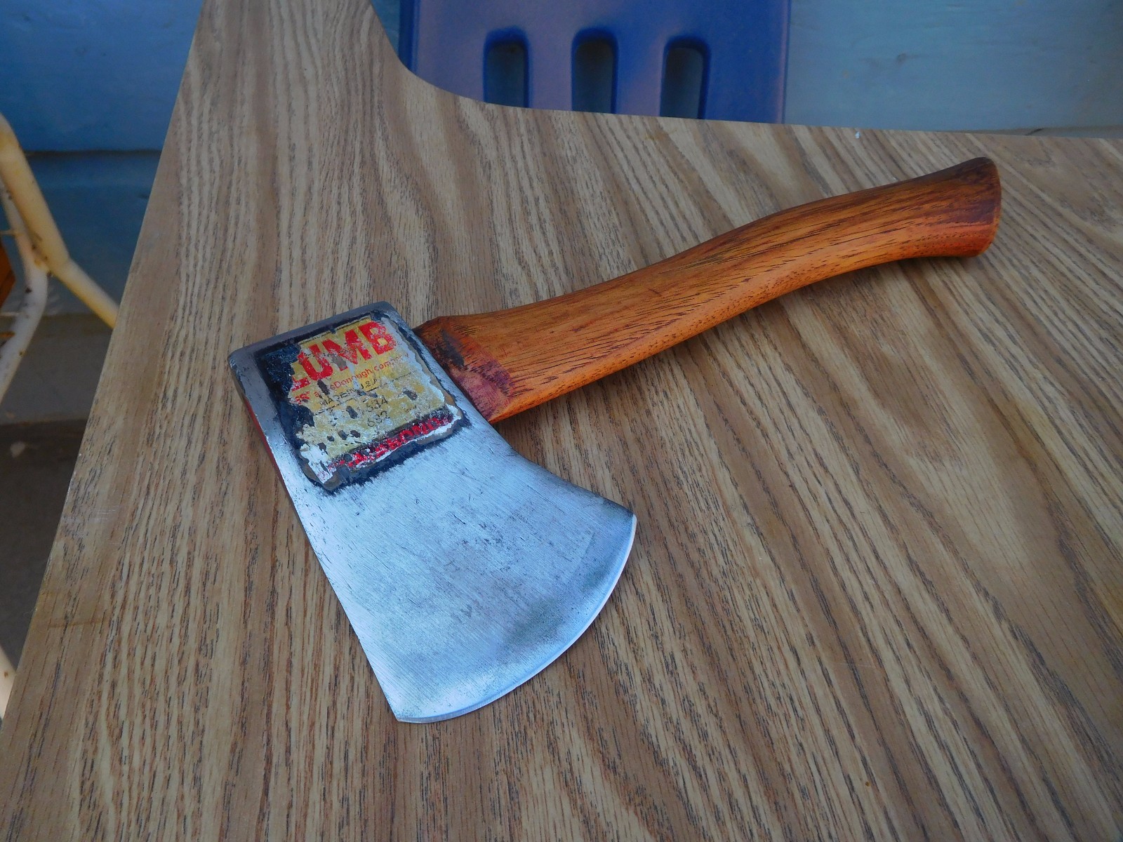

... and what looks like a Plumb National hatchet with Ames on the label:
VINTAGE PLUMB 1-1/4 LBS CAMPING HATCHET *NATIONAL PATTERN* ,10'' HICKORY HANDLE.
5'' LENGTH OF HEAD.3-1/4'' CUTTING EDGE,1 LB 10 OZ OVERALL WEIGHT.12'' OVERALL LENGTH.

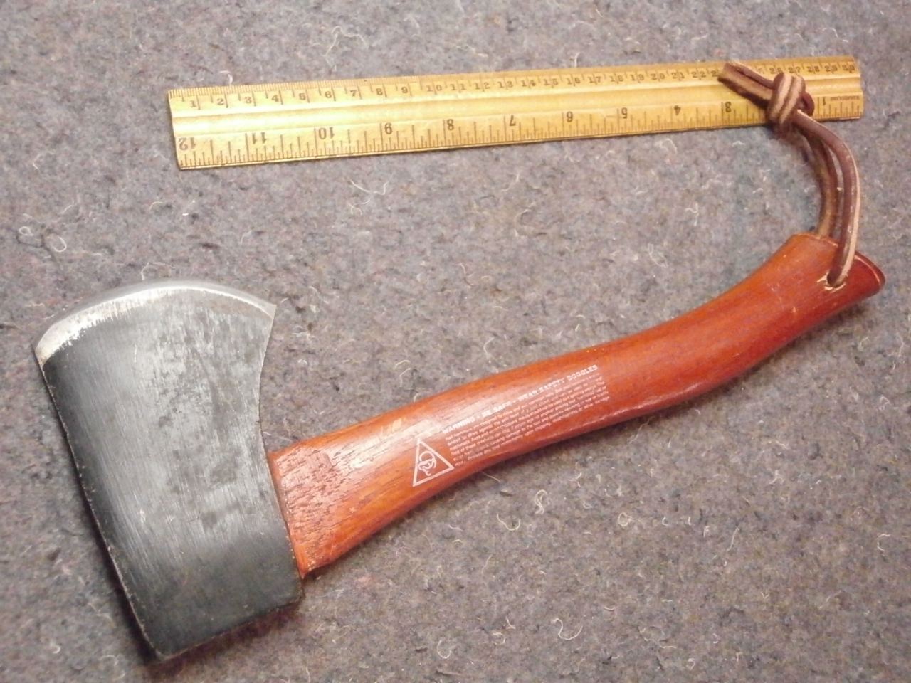

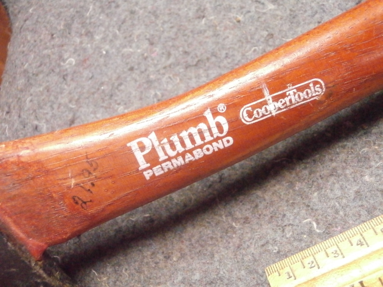

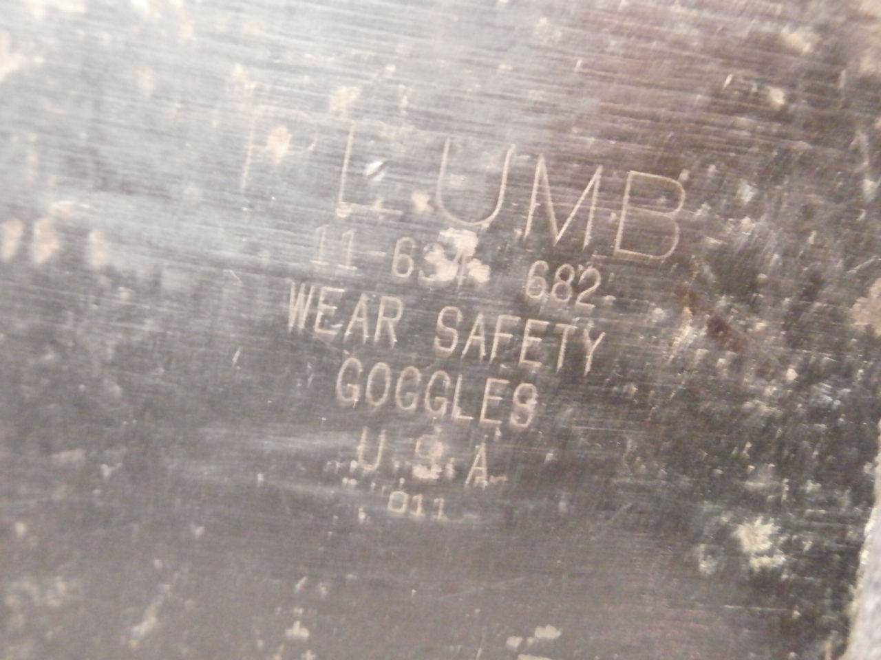

... and a Plumb from Cooper Tools (1981-2000+) which resembles the National pattern:
"VINTAGE TOOL/PLUMB 11-634-682 HATCHET/PLUMB PERMABOND/COOPER TOOLS"
Thank you Steve! The top pictured Ames boys axe is authentic-looking enough but the Ames and the Cooper Tools Boy Scout and other hatchet versions look like a cross between a conventional head and a National. It's probably safe to presume that the National pattern died out or was modified sometime during the Ames era.
