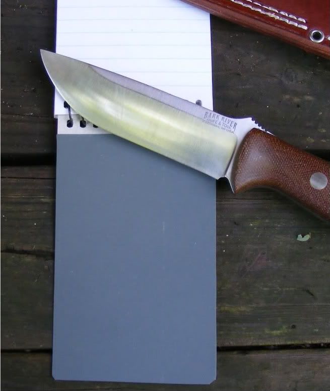

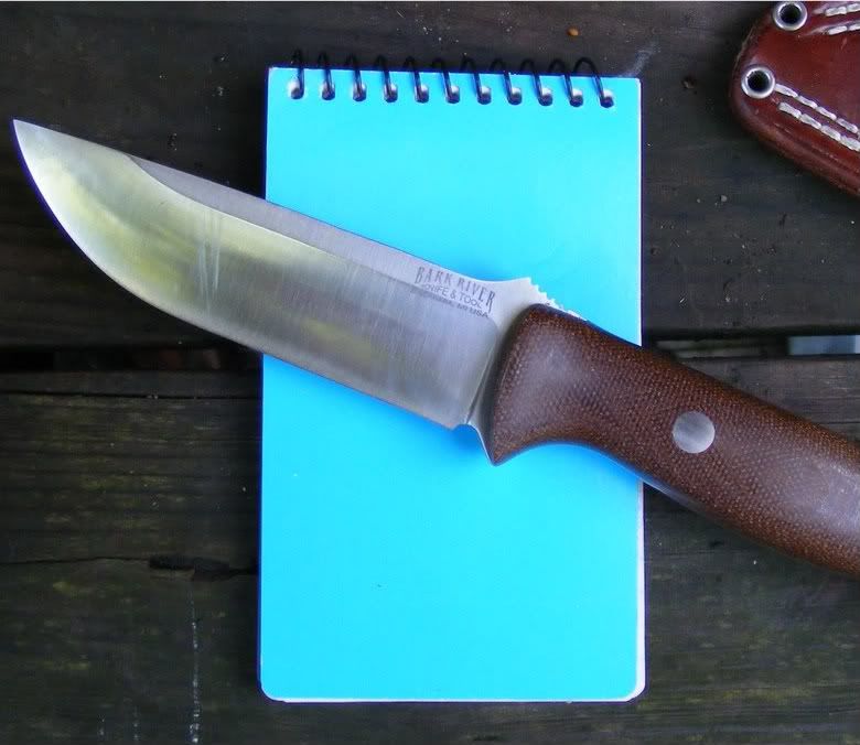

I like to carry a small notepad with me everywhere. On the inside of the cardboard covers , I glue a piece of 1000 grit wet/dry sandpaper from Auto Zone to use as a sharpener if one of my knives get really dull.
Inside the other cardboard cover , I wiped on some black Bark River compound to use for touch up.
To finish up , I use the glossy outside of the cover to polish the edge a bit.
Here's one that I just made up:
Give it a try. Works real well & you now also have something to take notes on.

Very nice, Clff! I like your creativity! :thumbup:

Well, there you go, looks like a great field sharpening solution. I just picked up a Bravo 1, so I'll give this a try.

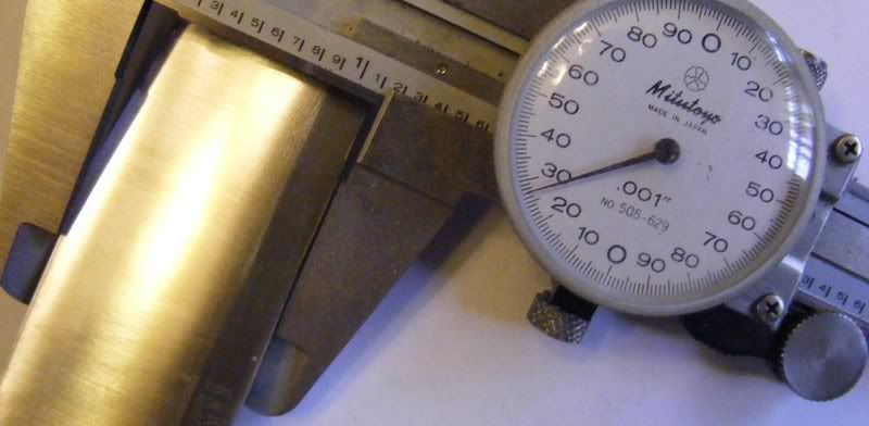

The blade on my Sandstorm is ~1" wide. Another favorite of mine is the CS SRK - it is ~1.25" wide... Anyone know how much wider the Bravo 1 is? What about the S1 - is it wider or more narrow then either of these? Also, how long is the Bravo1's blade exactly?
James: The blade on my B1 is 1.127" wide at its widest point:

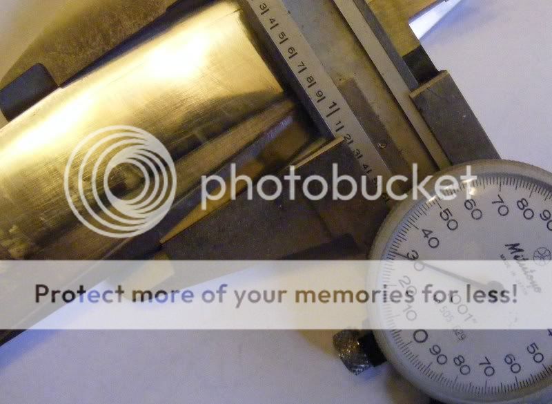

On my S1 the blade is 1.130" wide at its widest point:
The blade on the S1 gets a little wider just before the clip part of the blade than it is nearer the handle.
