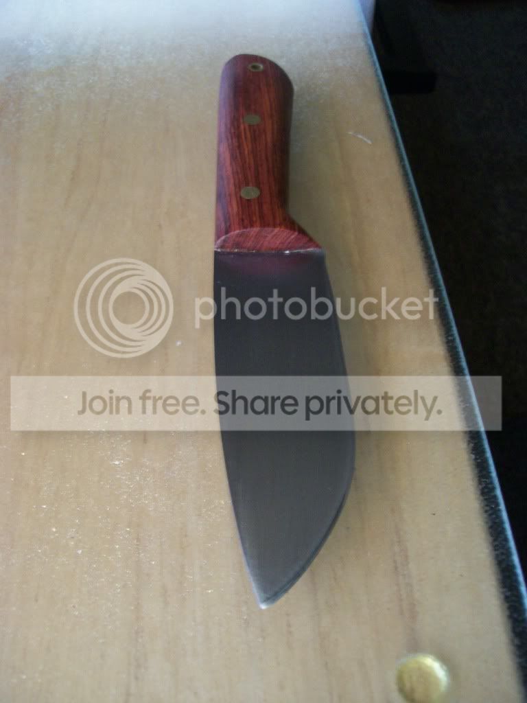

Hi all,
I just finished this knife on new years eve. I was thinking that it will be my new main user for the kitchen. It has a 4.5" long is 3/32" thick with a 1.5" wide blade and has a 4.25" long handle. This is the first time I have ever put cocobolo wood scales on one of the knives I have made. I really like the looks of them. I battoned it through some seasoned mulberry wood and then made up a couple of fuzz sticks as you can see in the pics. So far so good:D
This pic is a little out of focus.
I think it will work cutting up some veggies :thumbup:
Thanks for looking.
Bryan

That is a real looker! like the profile & the handle !
Cool knife! I like the angle you put on the butt end of the handle. Also, the brass/cocobolo combo looks real nice.

For regular kitchen use I like a little more of a 'drop edge', i.e. the handle is up near the spine with room for your knuckles when the edge hits the cutting board. Like a chef's knife or santuko.
Nevertheless, she looks like a keeper. :thumbup:

Rotte Maybe the next one I make will have more of a drop point. Yea the handle does sit up higher so I will not rap my knuckle. That is why I made this one out of so wide of a peace of steel.
Long bow the width of the blade is just under a 1.5" wide.

That's a good looking knife Bryan. Should do great in the kitchen. I might like a little more drop from the handle to the edge and another inch of length.

I love wood, but, if it's not ridiculously dry when installed on a knife, the loss of moisture in Winter months shrinks the scales and leaves an annoying, sharp edge all the way around the scales. I think highly oily SA hardwoods are not as subject to this as NA hardwoods though. As "traditional" as I tend to like things, I have shy'd from wooden handles but some make it very difficult to pass on - like that one.:thumbup:
