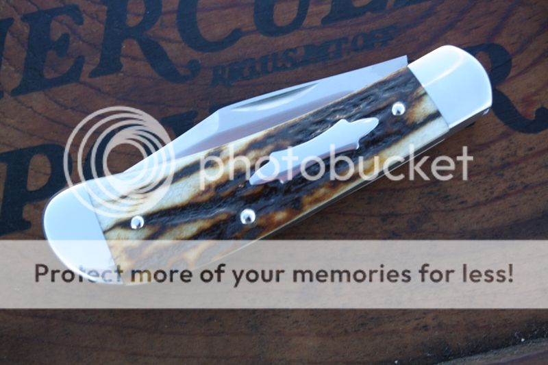

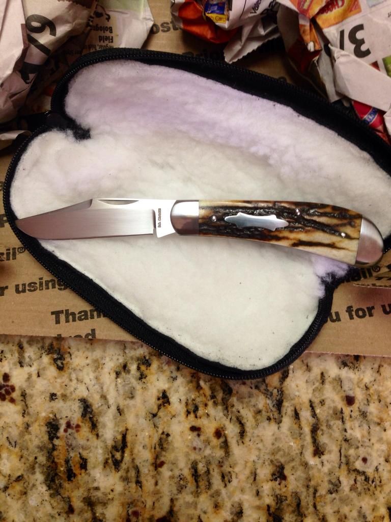

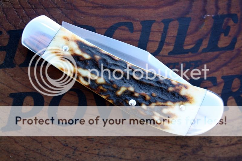

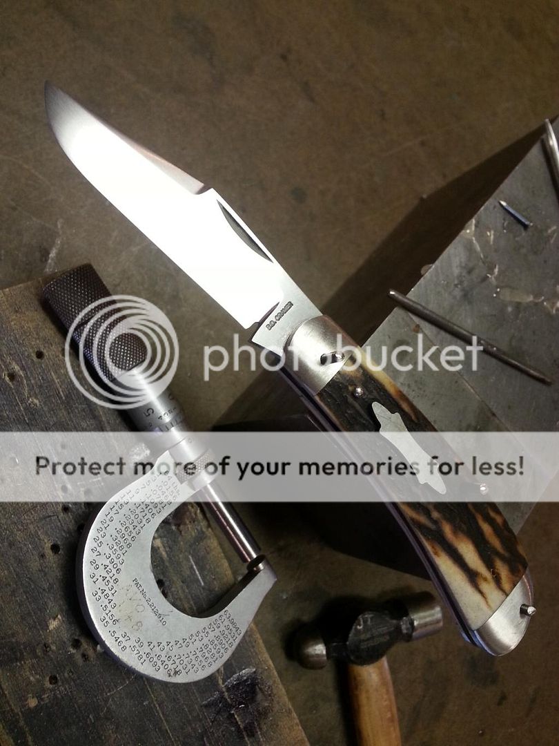

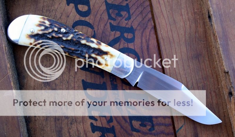

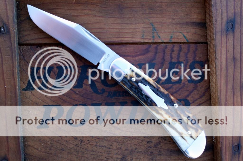

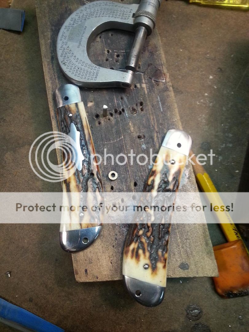

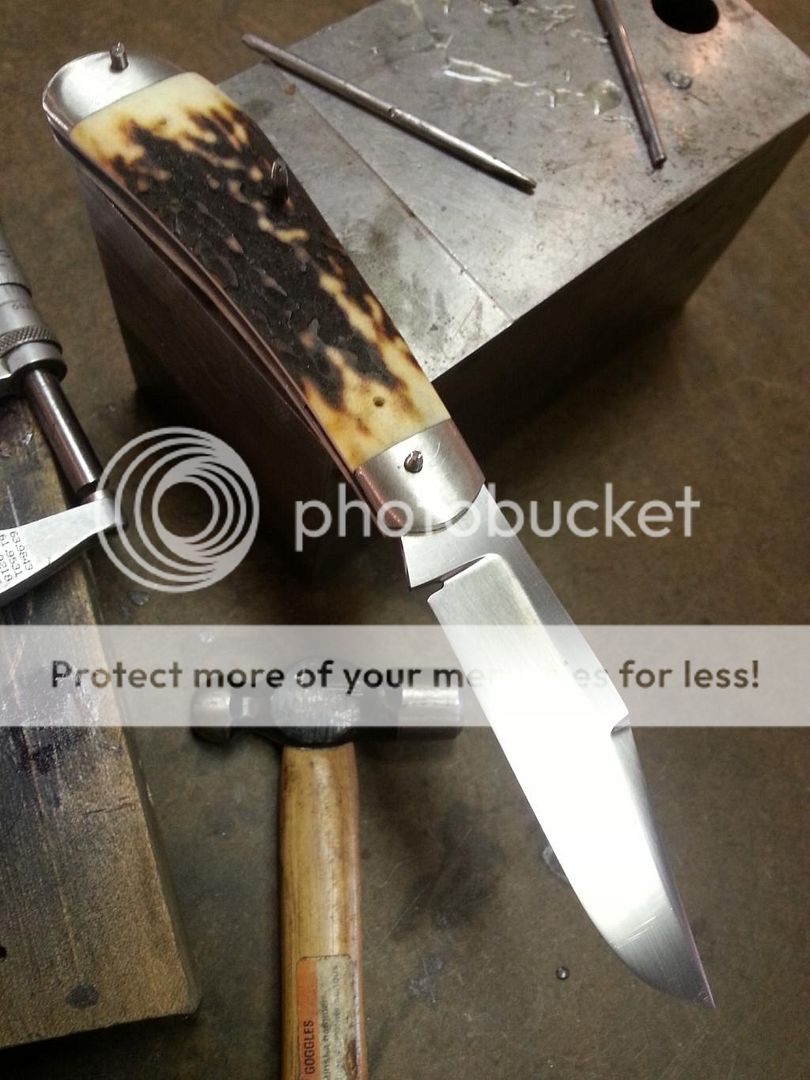

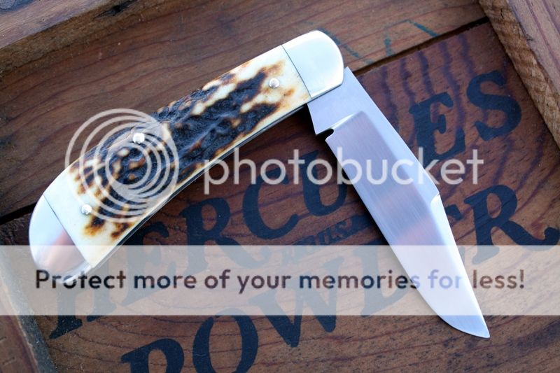

3 1/2" Lanny's Clip
Blade and spring are 154cpm and Rc at 61 and 49 respectively
Blade is centered nicely
Flush in all three positions
Pulls about a 6
Bolsters, Liners, Shield and Caps are stainless
Scales are Antique Elk Stag
Just beautiful, Brent! Thanks for sharing it with us.

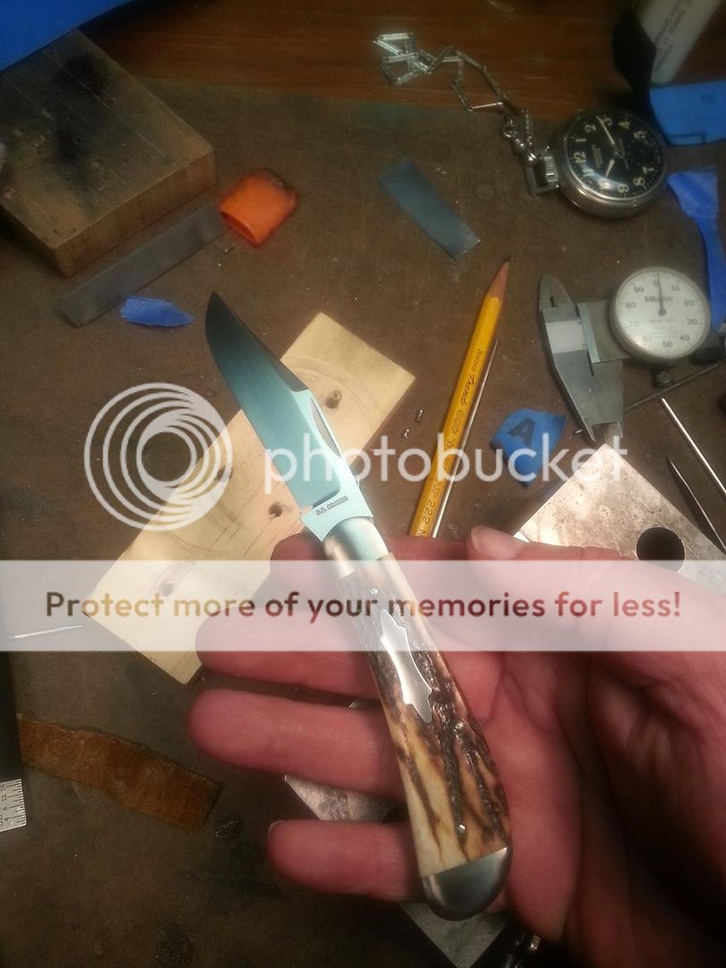

As always, beautiful work Brent! I always love seeing WIP pics but these have a little more meaning to me ;)such richness and warmth on that stag. Love your work Brent!

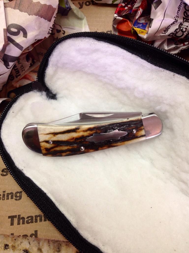

A package from Brent!
Wadded up paper....thanks Brent?
I'm gonna like what this pouch is hiding!
What a thing of beauty! Perfect! Thin, lightweight, perfect for the pocket!
Thanks Brent. What a great job! Super impressed!
"went stag"..........Good one Brent.
Beautiful work!

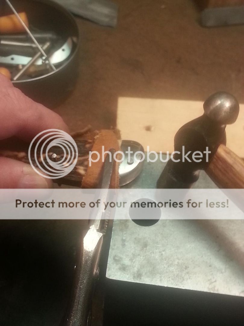

Thanks for the WIP's. I know that's a pain in the rear end for you, we all appreciate it!:thumbup:
