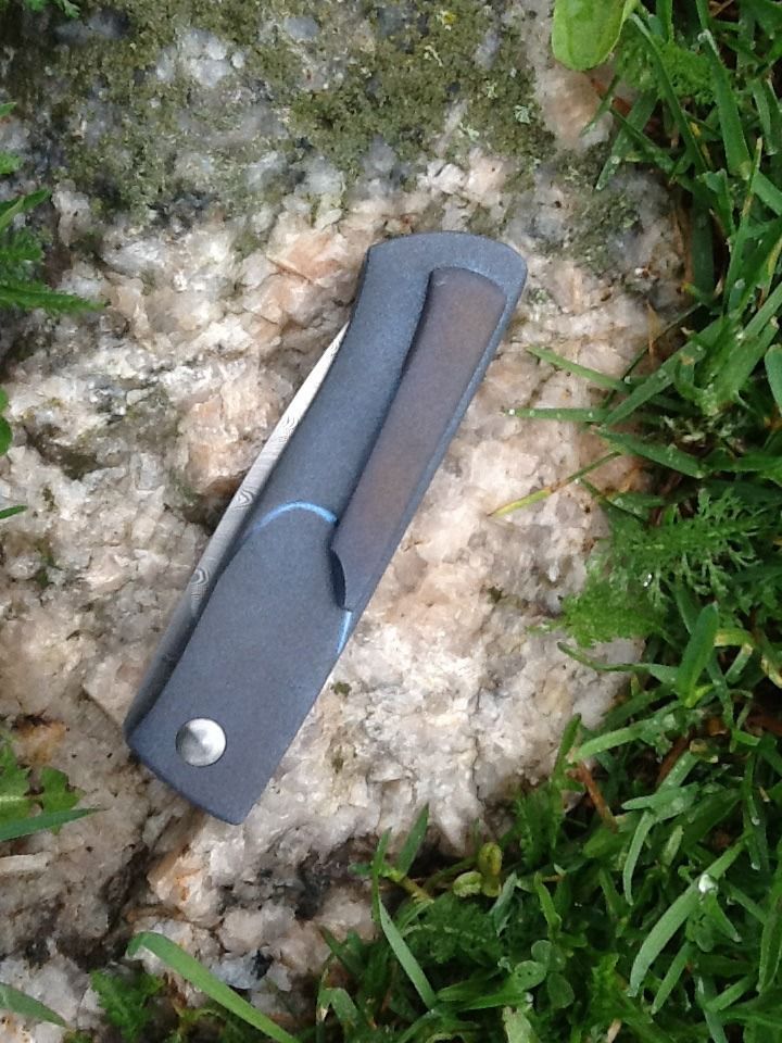

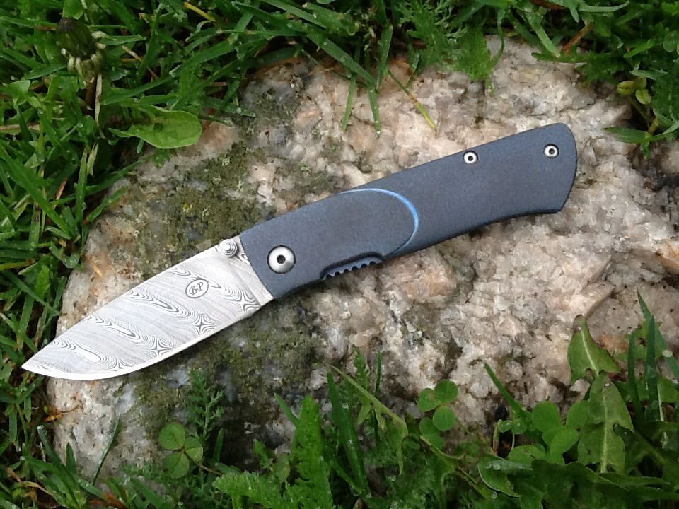

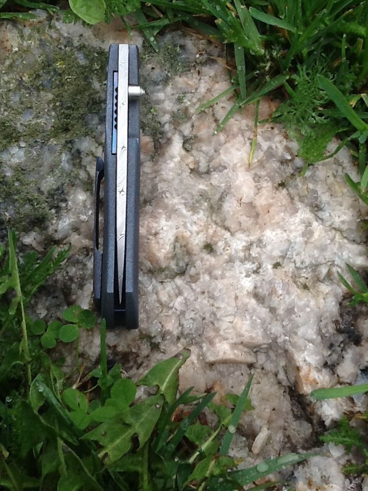

This one is my latest and a new pattern for me. I drew most of the inspiration from an old Buster Warenski fixad blade that really appealed to me. I'm pretty happy with the way this turned out allthough there is still room for improvement. This one is the smaller version, I have one that is 10 per cent bigger and more of a full size folder.
Specs are as follow:
Blade 3" Damasteel twist at 59 HRC, approx 1/8" thick.
Handle just a tad under 4", titanium 6al4v, carved, coarse sandblasted and anodized
Backspacer in titanium grade 2, polished and anodized.
Inlayed (nested) lockbar in 6al4v, dovetailed into place.
Milled titanium pocket clip
Stainless hardware, phosphor-bronze washers
Critique and comments are welcome.
Brian
oh my, that is VERY nice!! I really like the clip design too. The ti anodization and surface treatment looks great, although I'm not sure that ti color makes the best contrast with the damasteel, as opposed to bronze maybe, but that's personal preference
Thanks guys, appreciate Your feedback.
@ Fishface,
I have to agree with you on the colour. Sometimes it locks better in my head than in real life. You had a great idea there. Thanks.
Brian
Very nice!
I do like the dark Ti and damast.
To me the dark looks discrete and business like and the damast gives it the extra, the class and luxury.
I EDC the folder I have from you and love it.
Well made, smooth action, the sand blasted Ti feels good and secure in hand and the looks are sweet
You make a fine knife
Thanks Hengelo. Glad to hear you like it. The hunter I got from you, has gotten dirty too:thumbup:
Brian
