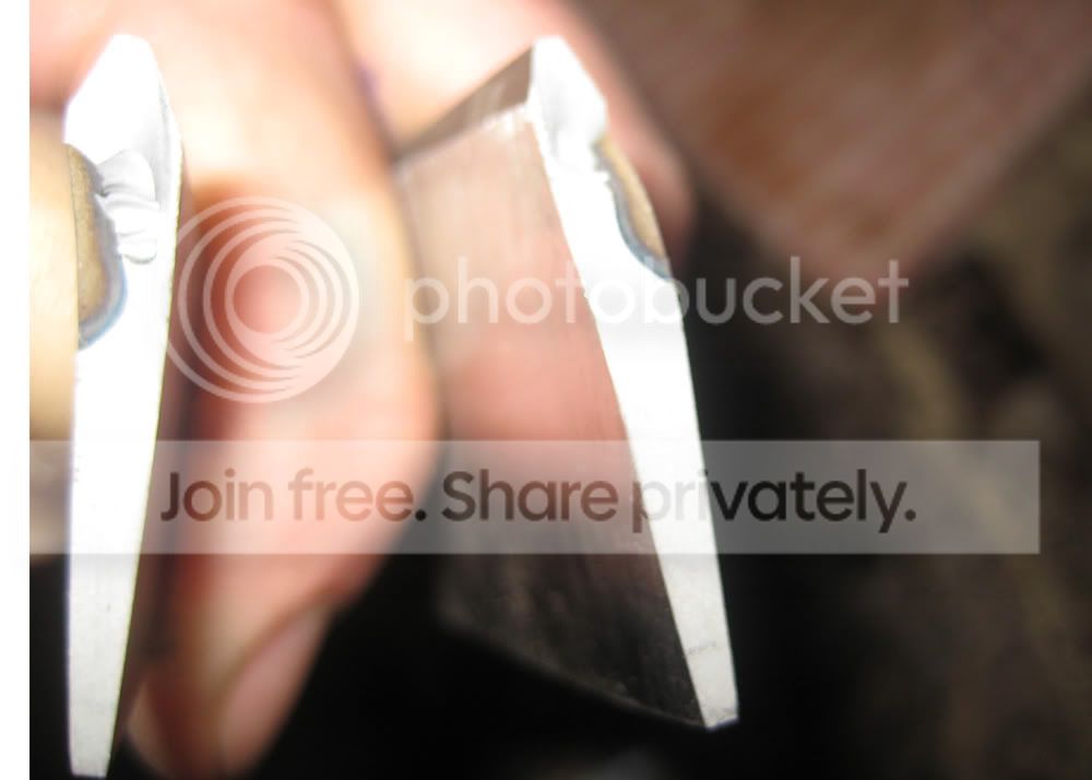

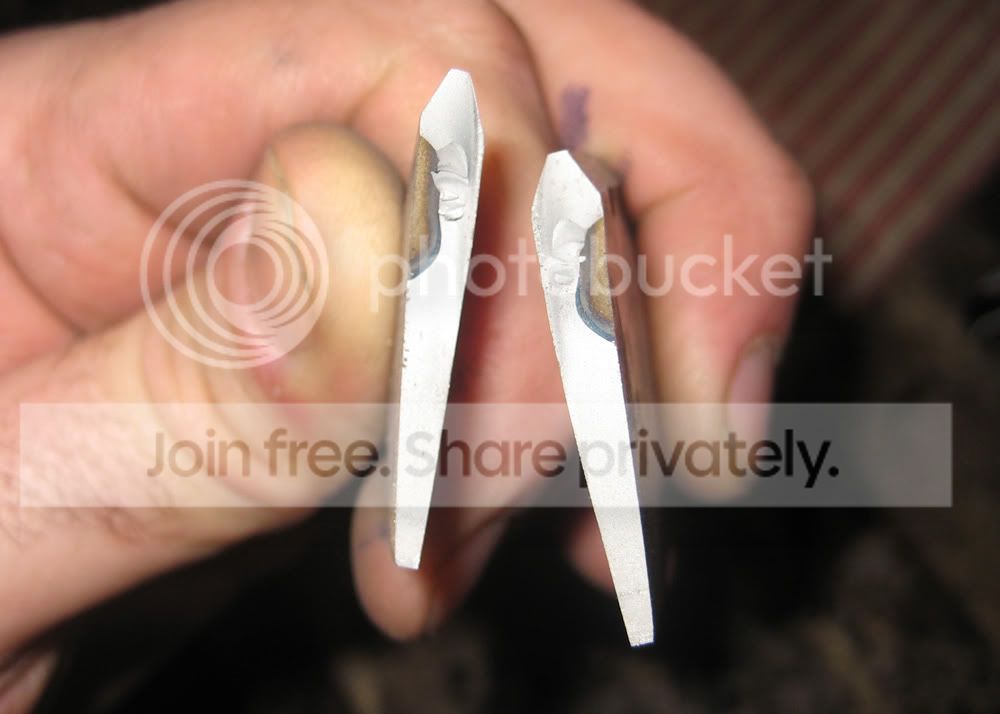

OK, I am kinda sori I did it now. I tempered it last night, and went to finish sand it this afternoon, but I noticed a small line that had tempered darker. I checked the other side and did not notice the matching mark. I looked at it more closely and thought it might be just an odd scratch, but when I went to sand it out...it stayed. It was wierd, it wasnt along the edge where I would have expected it, and it didn't go all the way through the steel, but when I put it in the vise, it snapped easily along that line. On a lighter note, the grain was as silky smooth as I have seen.
Here is a pic or two of the results.
I already have another ground out normalized and fitted to a guard, but I think I will stick to Park's for a while.
Might take a crack at that brine thing again someday soon.
Looks like a couple of really nice little Kiridashis to me! :D
Sux, though. Sorry bout yer blade. As much as I'd love to try and get all the extra activity, I believe I'll just stick to the Parks 50.
Perhaps someone could explain this failure to me? Why is there discoloration extending down into the blade, was this a flaw in the steel that was present before heat treat? Or was this failure caused by something else?
I am guessing that the crack occurred during the quench, and the colors inside are due to the tempering process.
